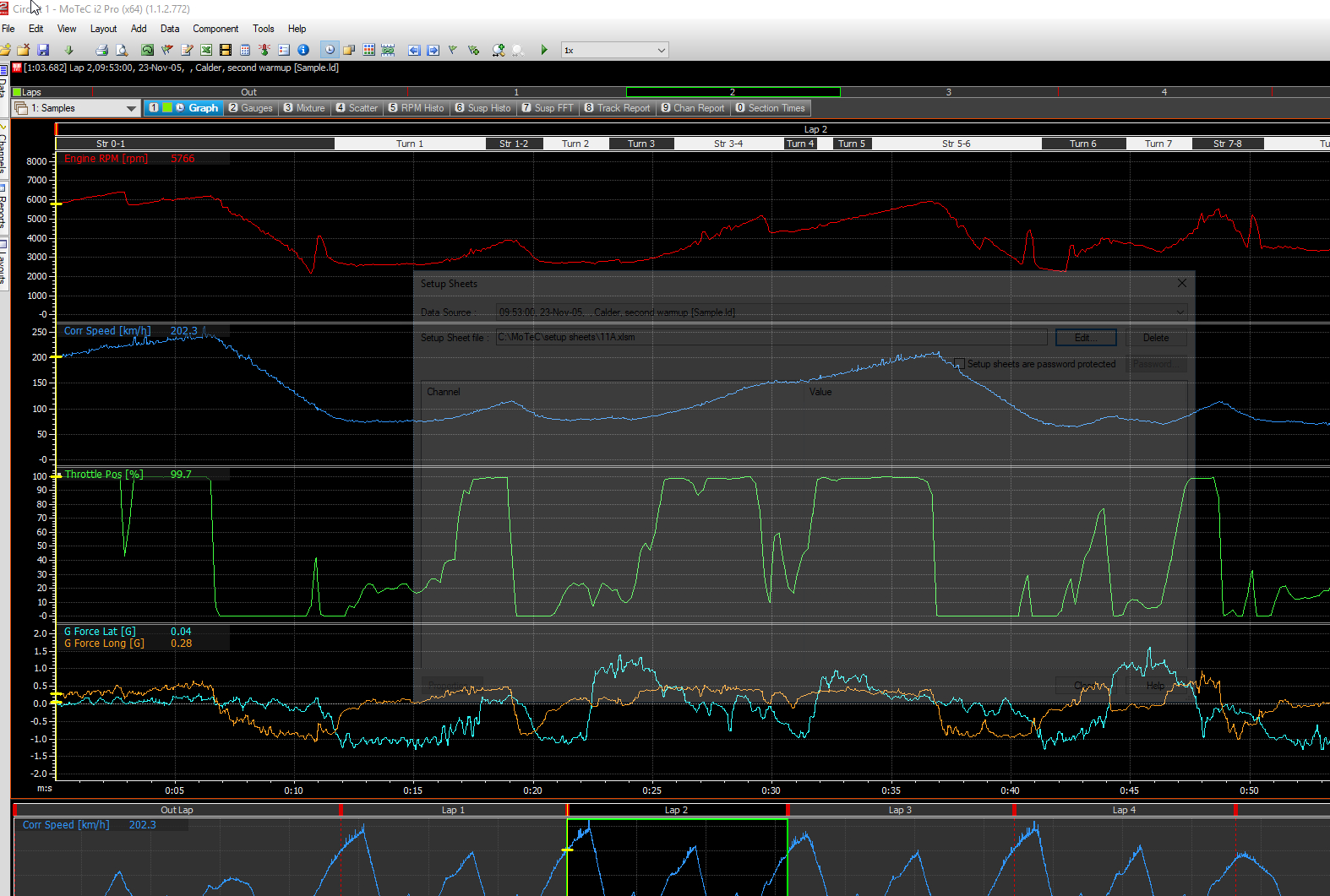

In a fresh project i create a new Setup Sheet - it opens up excel and show the sheet - top bar shows its xlsm format.
I either now punch in values and save the sheet - confirming that its still xlsm format and close it. I map my way to the sheet and confirm its xlsm format.
In motec i can see the sheet in Setup Sheets (CTRL T), no values are shown in the window. I open the sheet and the values i punched in there are still in the sheet.
Its like MoTeC is not reading the values or that its discharging them.
Tested with totally new worksheet, using the sample logfile "Calder" as well as my own stuff.
Windows 10, office 7, Motec 1.1 i2 pro

Go to C:\MoTeC (create the folder if it doesn't already exist) and then create a folder called setup sheets. In i2 go to Tools>Options>Analysis then tick the "Save Setup Sheets to a custom folder" button. Select the folder you just created and see if that works.

Unfortunately its not working for me - i tried C:\MoTeC\setup sheets, C:\MoTeC\Setup Sheets, C:\MoTeC\setup_sheets and C:\MoTeC\Setup_Sheets
I tried with my own worksheet and with a fresh created Circuit1 using the Calder logfile from the samples.
Still no go.
