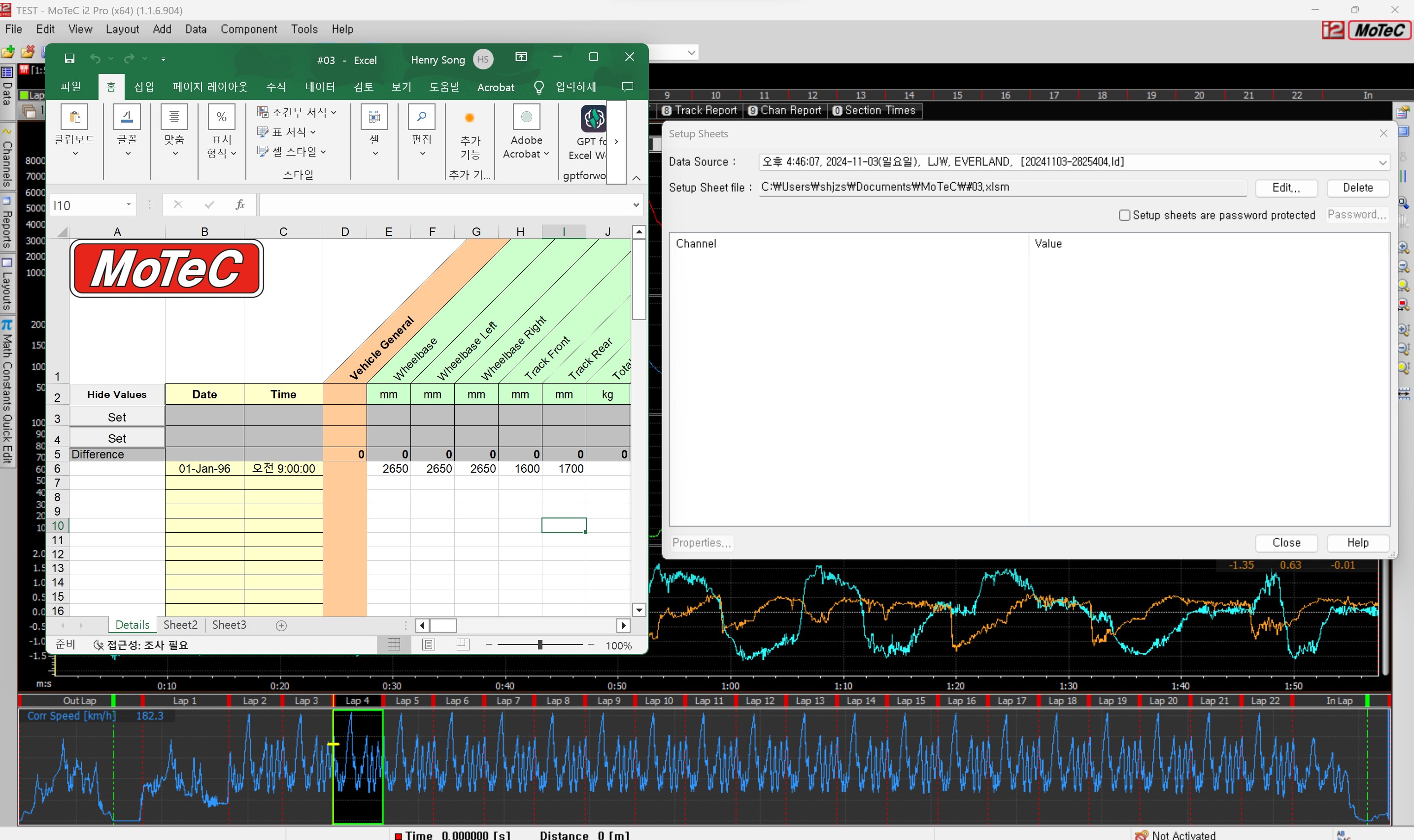

I was using i2's set up sheet well.
However, since last week, the set up sheet is not connecting to i2.
I have reinstalled i2 pro several times but it doesn't work.
Even if I enter data in the set up sheet, nothing is displayed in the i2 channel window.
Has anyone experienced this issue or know how to fix it?
set up sheet issue.jpg (737.54 KiB) Viewed 3761 times

Postby buzzard73 on Sat Feb 01, 2025 8:30 am
It looks like your date is incorrect - 01-Jan-96.
The date on your setup sheet must match the date on your motec telemetry file so i2 knows which setup to match to the session.
Look at how my session data date and time matches what's on the setup sheet:
