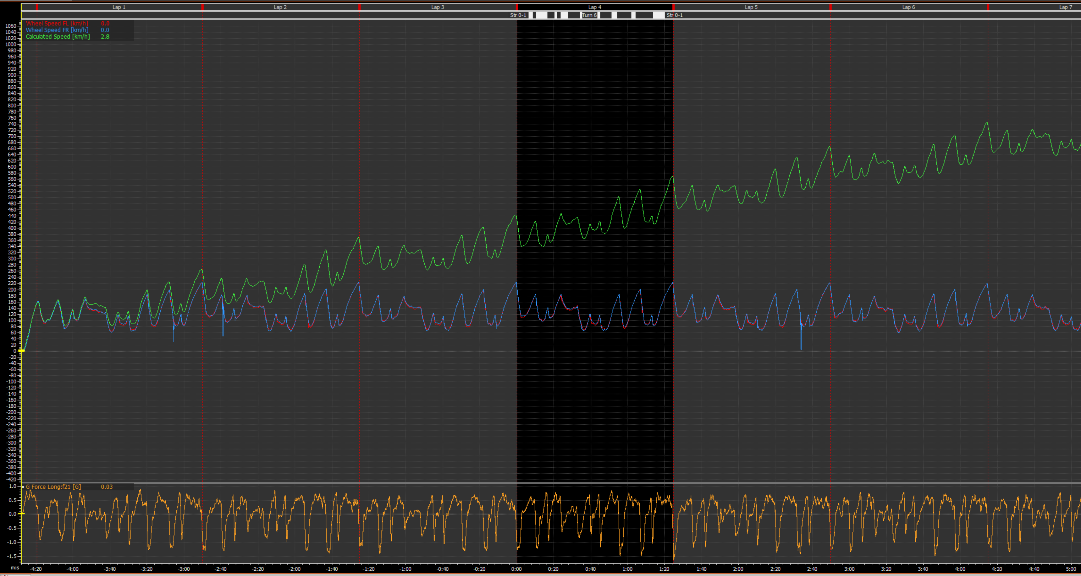

Below is an image showing what David is talking about. "Calculated Speed" is the integral of the G-Long channel, with no resets. The biggest problem with integrals is any noise in the signal (of which there is a lot in a G Sensor trace) creates an offset that continually accumulates.
When compared with wheel speed sensors you can see it is pretty accurate for the first 1/4 of the lap and then after that the error just gets bigger and bigger. Determining when to calculate and when to reset is the most difficult bit.
I would suggest testing your maths on some data where you have a known speed trace to compare against (the sample data provided with i2 will work).

Also I reviewed my race data to compare GPS speed and integrated Ax, Ay and z, it was a total difference.
Mine could not even match with samples in screenshot!
As pointed out the drift in acceleration signal makes a lot difference.
Should find out better way out....
