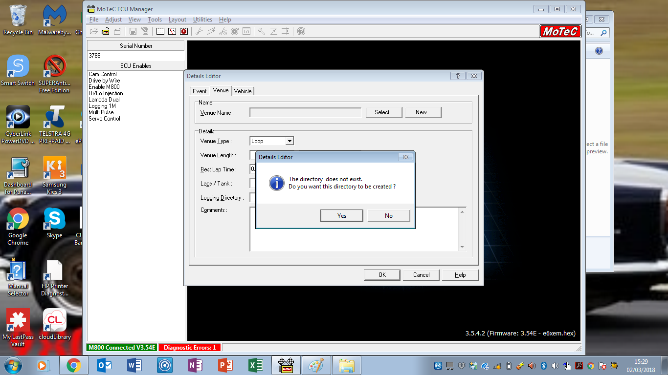

i have uploaded some new files from practise today.
when it finishes uploading the data , i get the following message. no matter what i do, i cannot seem to create a new venue and save it . there is a drop-down menu which gives me a selection of tracks, but if i try to use that, i get the 'directory does not exist" message
I can save all the data no troubles, but this bit is annoying

Postby David Ferguson on Sat Mar 03, 2018 4:33 am
Have you tried clicking "yes" so it can create the necessary directory? I normally see this when the "Logging Directory" doesn't exist yet for a new venue.
In order for someone to duplicate your issue, can you provide info on what version of Windows OS you are using, what the logging directory and venue name are set -- essentially we need to understand the exact steps you are taking. You really haven't fully described what you did before getting the "directory does not exist" message.
I'm sure we can get this sorted.
