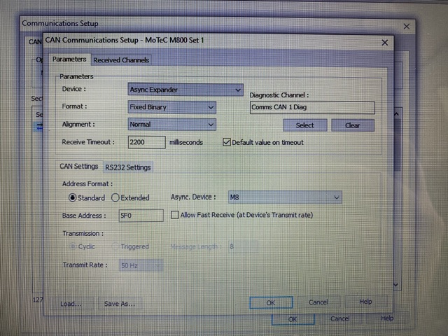

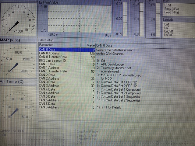

Setting up the custom CAN between the M800 and the dash can be tricky, can you post your M800 calibration and the C127 calibration?
Posts: 1831
Re: Subaru WRX 7 board AV7 fuel level sensor
Postby Pepituning on Thu Sep 05, 2024 9:38 pm
Pictures attached

Postby Pepituning on Thu Sep 05, 2024 9:39 pm
Dash CAN

Postby Stephen Dean on Fri Sep 06, 2024 2:45 pm
We need the actual files so that changes can be made, screenshots are not of use.
