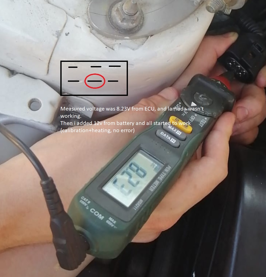

Then i do some measurements and i figured out that on pin where should +12v be, there is voltage from around 6-8v.
I measured also resistance of wires and everything was ok from ecu to lambda connector.

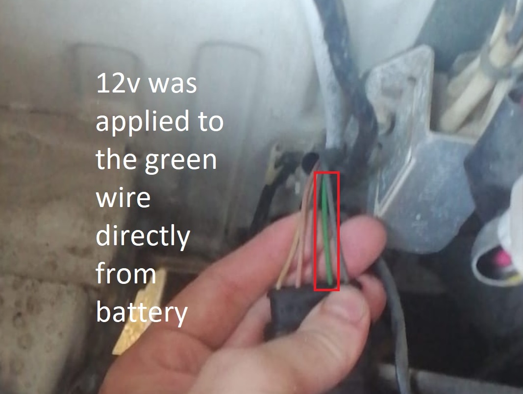

Next thing i've done i stripped a bit of insulation on +12v wire and connect it directly to + on battery to test what happens and lambda started to work. No more error and also calibration was done perfectly.

Can you please post a photo showing the wire that has been added thanks.
Posts: 1831
Re: EVO 8 GR.A Lamdba problem
Postby saggi91 on Thu Jul 25, 2019 8:46 pm
Here is the picture of wire where 12 was aplied:
