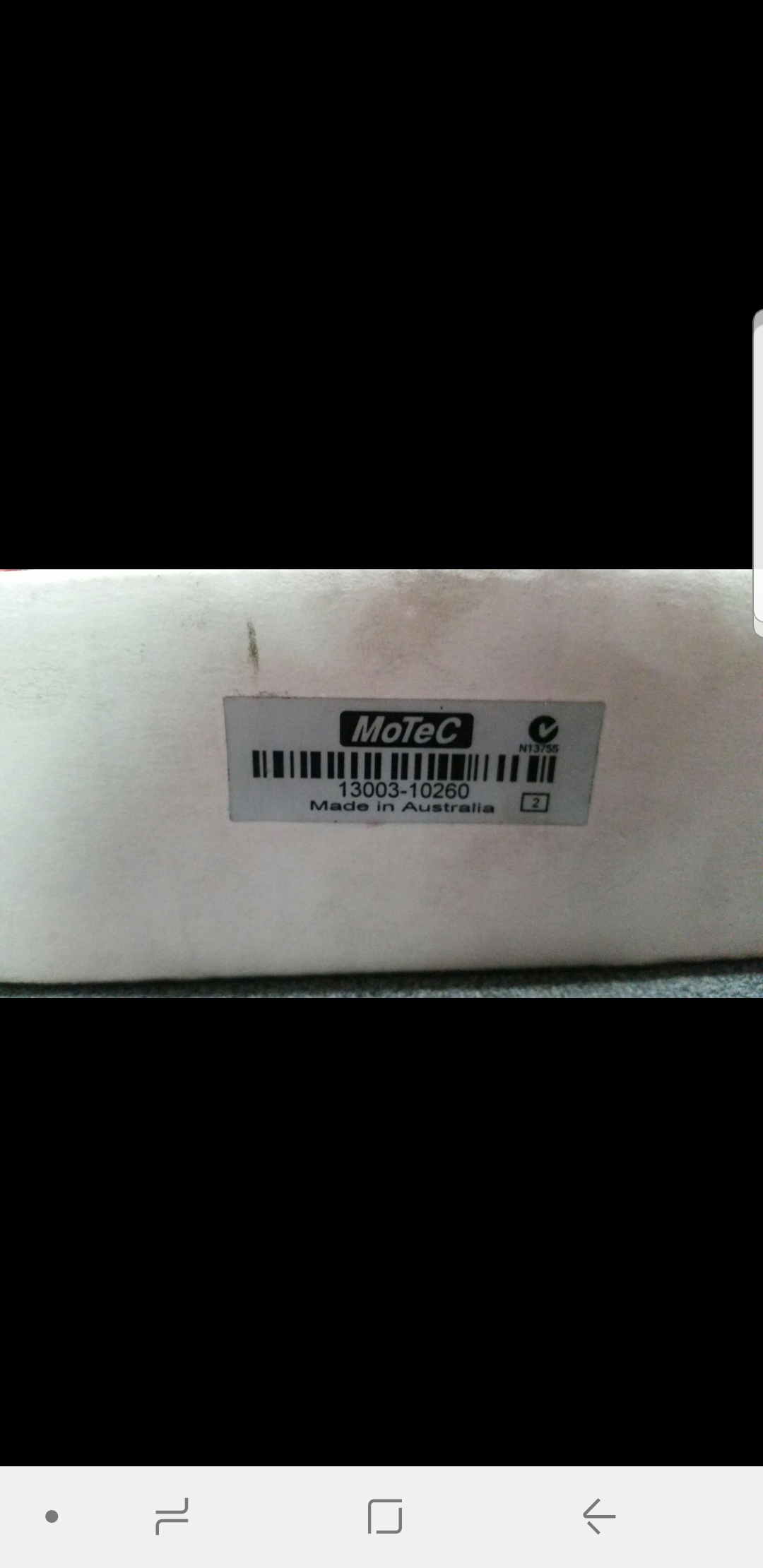

Hi guys,
I'm looking to fit a wrx 910 PnP module (13003-10260) to run a Australian 2005 Sti Ej207. It is going into a dedicated racecar, so the wiring harness will be custom made to suit.
WRX 910 has FBW and the AVCs on the exhaust side that is not fitted to my motor. Apart from these two differences, I ther anything else on the board that will stop me from fitting this onto my engine?
I have the wiring diagrams for both the WRX 910 PnP module, and also the WRX 78 PnP module. between these two I should be able to make a custom harness. There are a few description differences between the pins on both boards that i will need to research.
* Is there anything I havent thought of that will stop me from doing this?
* Can anyone tell me if there has been any options added to this board?
cheers
Al

Hi Al,
That ECU has DBW and Cam Control enabled.
I would retain the DBW functionality with the 207, rather than trying to get the IAC valve working using an ECU that isn't designed for it.

Postby Stephen Dean on Tue Oct 09, 2018 10:59 am
Hi Al,
You can use the SDC2 with this ECU.

Postby Stephen Dean on Fri Oct 12, 2018 1:46 pm
Hi Al,
That ECU has;
Advanced Functions
Cam Control
Drive By Wire
1M Logging
Posts: 1831
