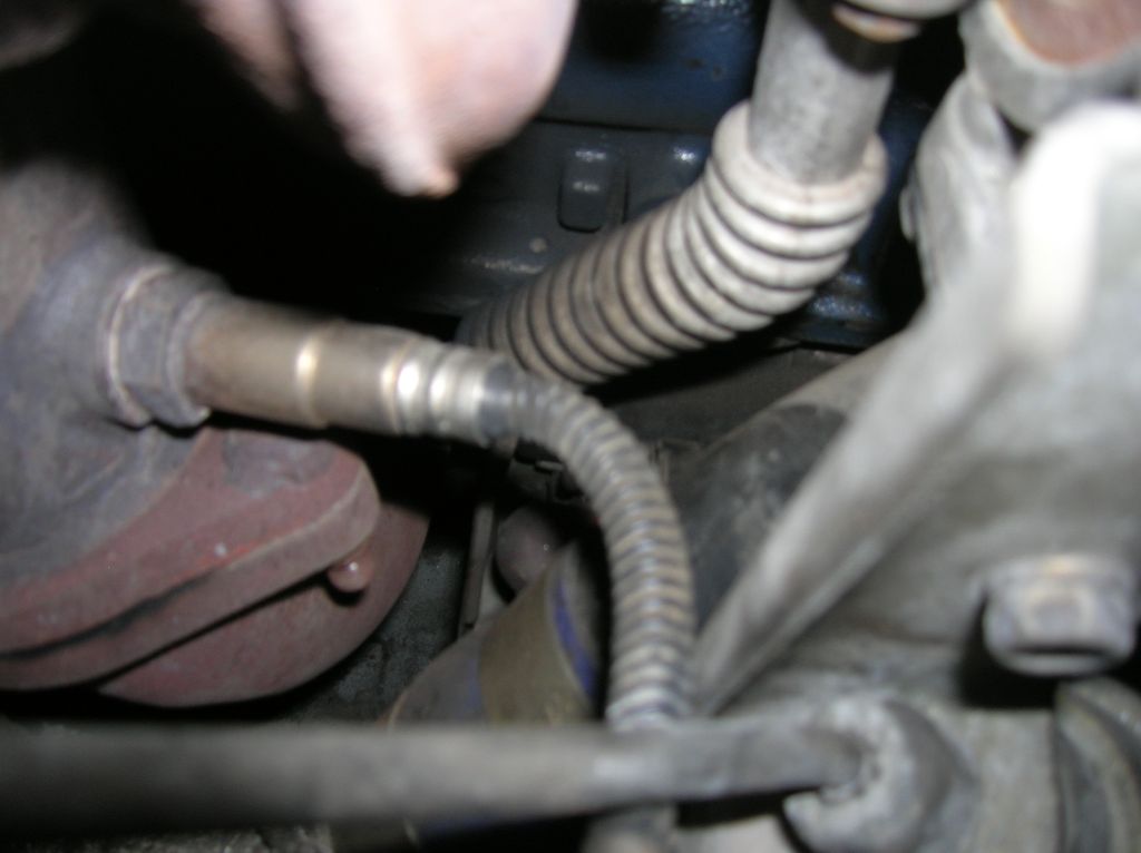

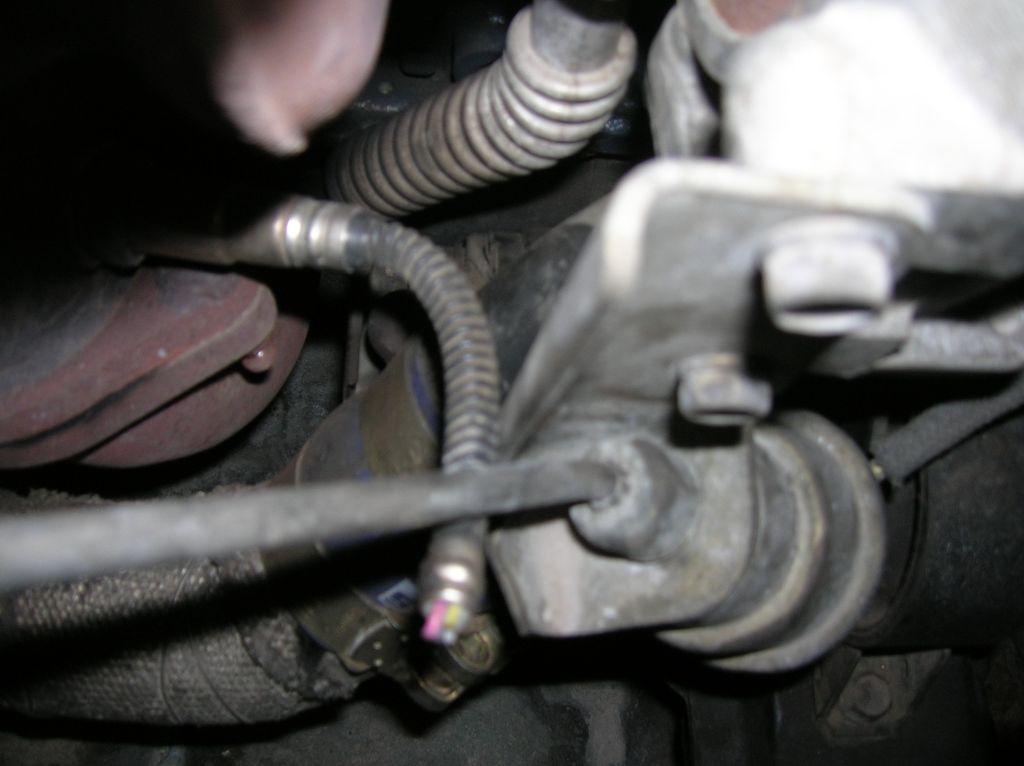

If you post a picture of your sensor and the connector I can identify it for you. YOu can connect a lambda sensor directly to an M800 and it will work provided that you have the Lambda option enabled.

I will take a pic of the 02 sensor when get a chance (soon) it's kinda tight down there. Judgig by the look of it, looks like it is a wide band sensor instead of a regular o r narrow band sensor, it does just look like my friend's LC-1 WB sensor, the only thing with this one is cutted the wires, so no mini module in the wire or connector. In other words, the Motec is runng with out o2 sensor feedback.

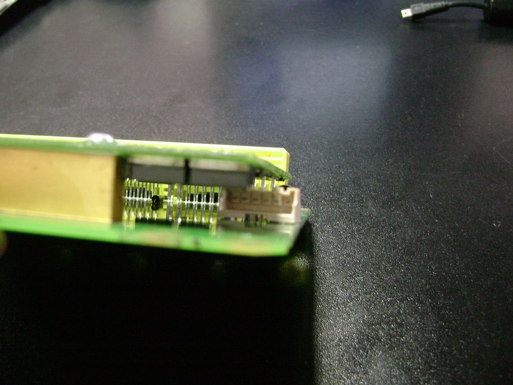

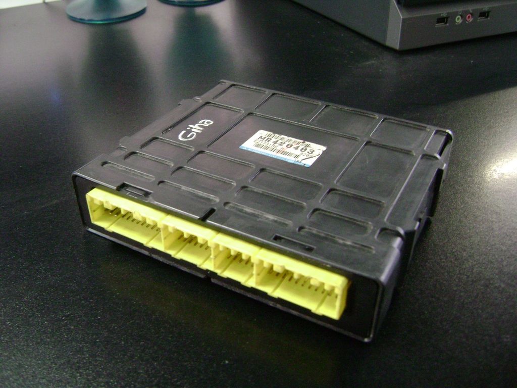

Postby Kemoly on Wed May 27, 2009 12:39 pm
my M800

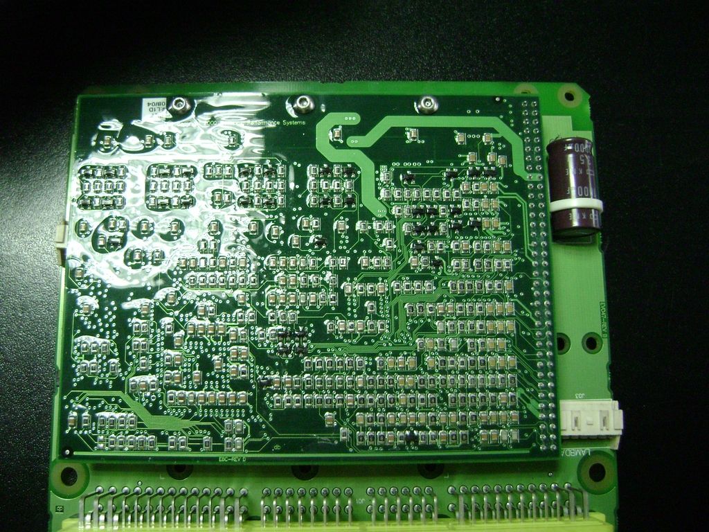

Postby Kemoly on Wed May 27, 2009 12:42 pm
The last ones

Postby Kemoly on Wed May 27, 2009 1:22 pm
my O2 cuted
