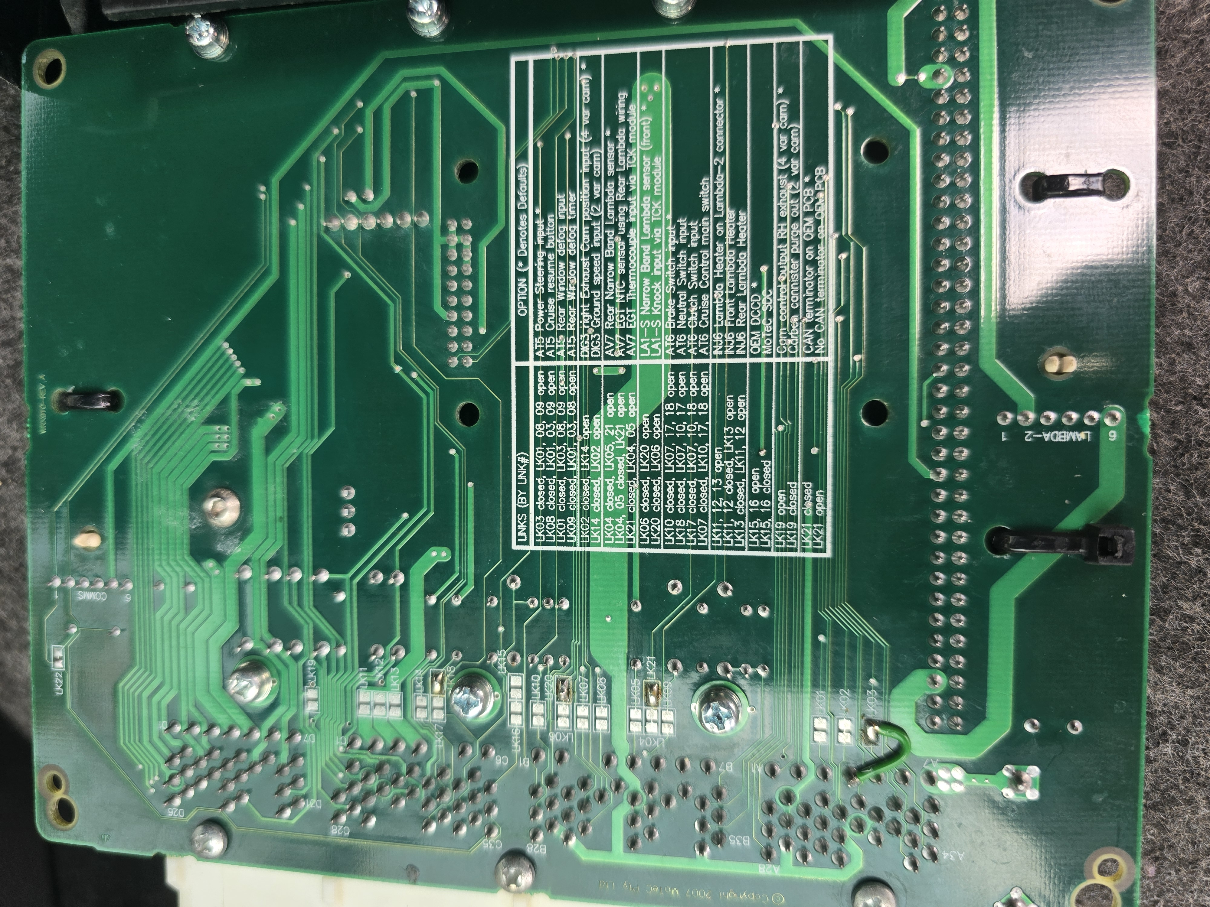

Can you post a photo of the underside of the ECU board?

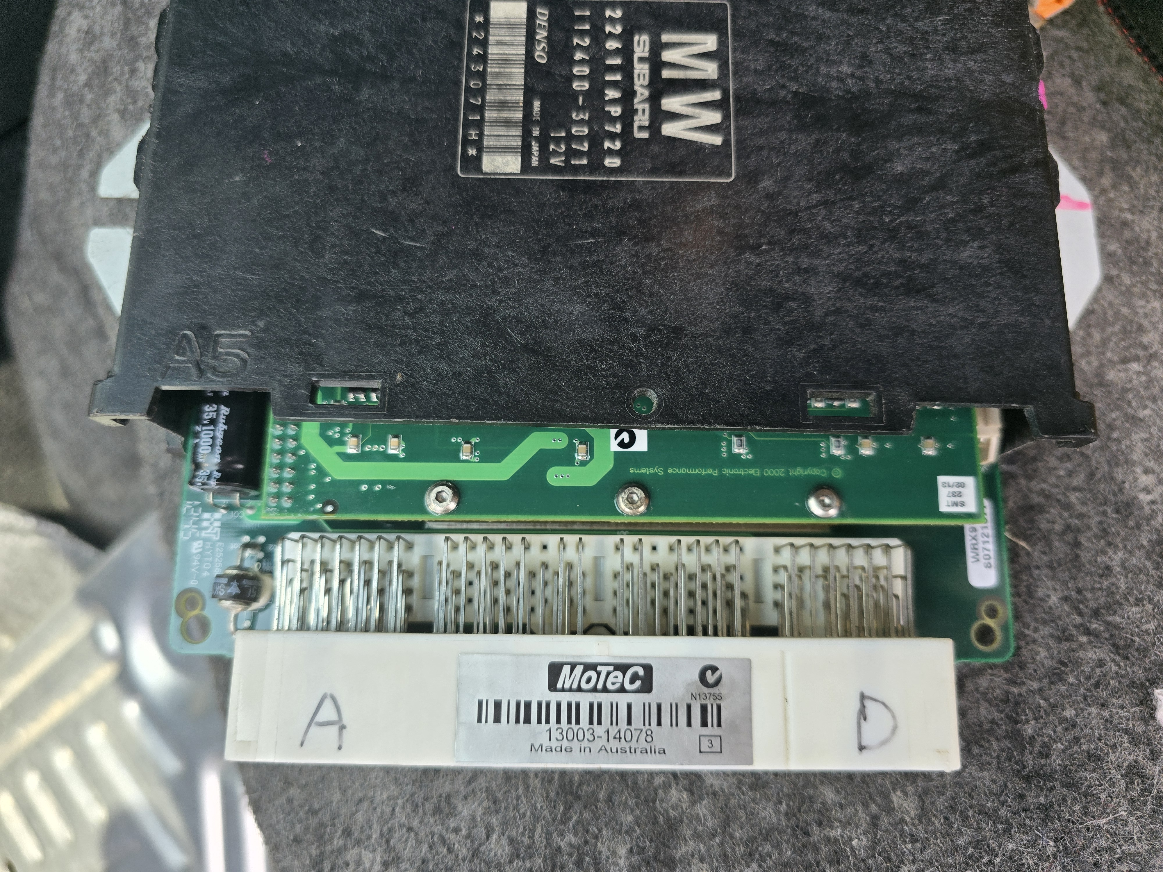

Postby Tunedgether on Thu Mar 28, 2024 4:13 pm
Please see attached pictures.

Postby NathanB on Thu Mar 28, 2024 4:48 pm
You have a Revision A adapter board.
The Additional links from the document are only present on the Rev B and Rev C boards.
