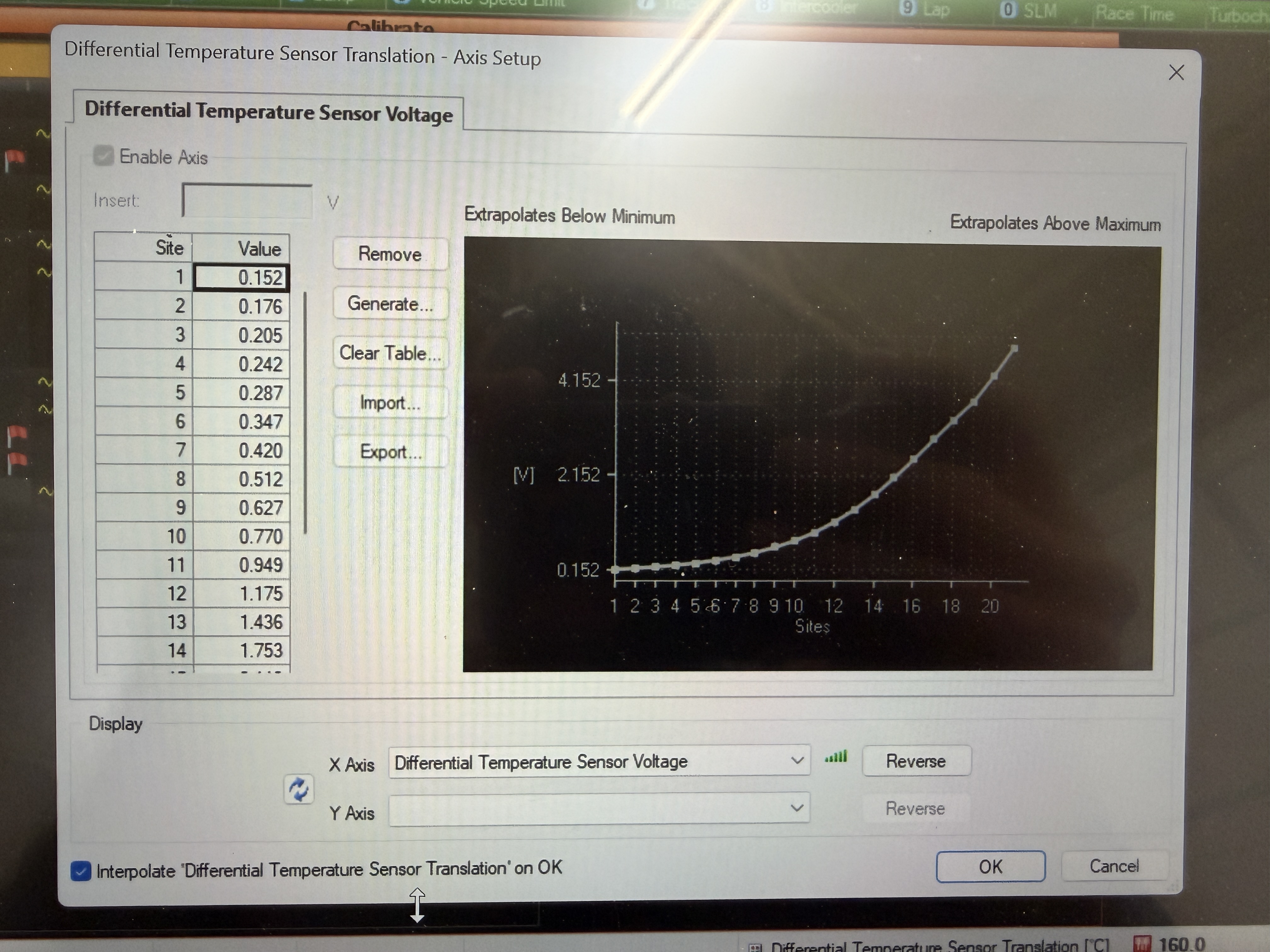

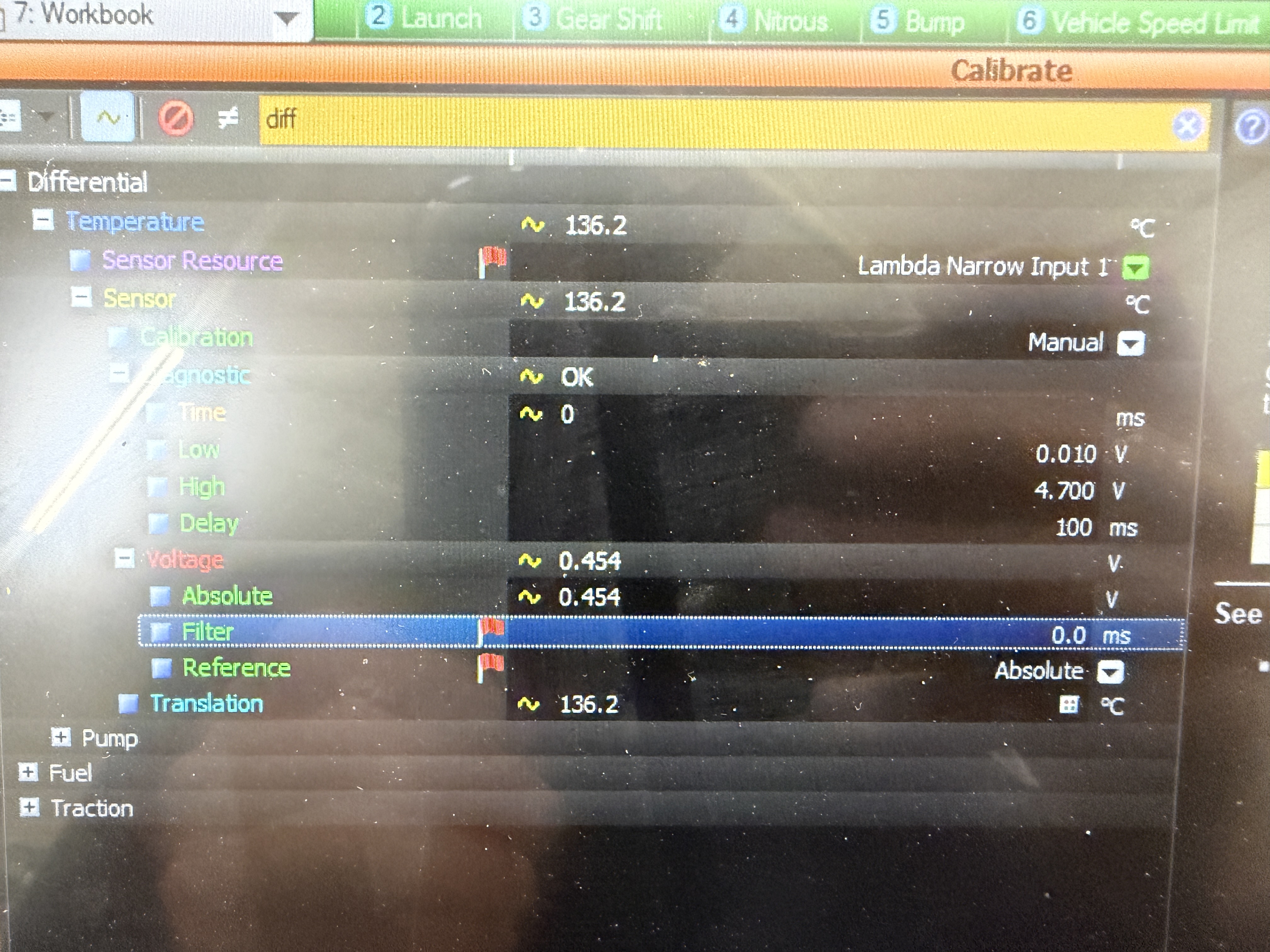

Hey guys, how do i setup this RaceGrade 1/8 temp sensor? they wired it to "Lamda Narrow 1" channel. i have the voltages entered, not sure how to check if pull-up is active.
here's a link to the docs. sorry for the huge pictures.

do i have to change the axis?

The lambda narrow inputs aren't really suitable for a temperature sensor.
You should be using an AT input.

To use the Lambda Narrow input you will need to wire in an external pullup for this sensor.

ok i think i gotta find a sensor 5volt supply and tap into that and then the other end goes to the signal. sorry im still learning all this technical stuff.

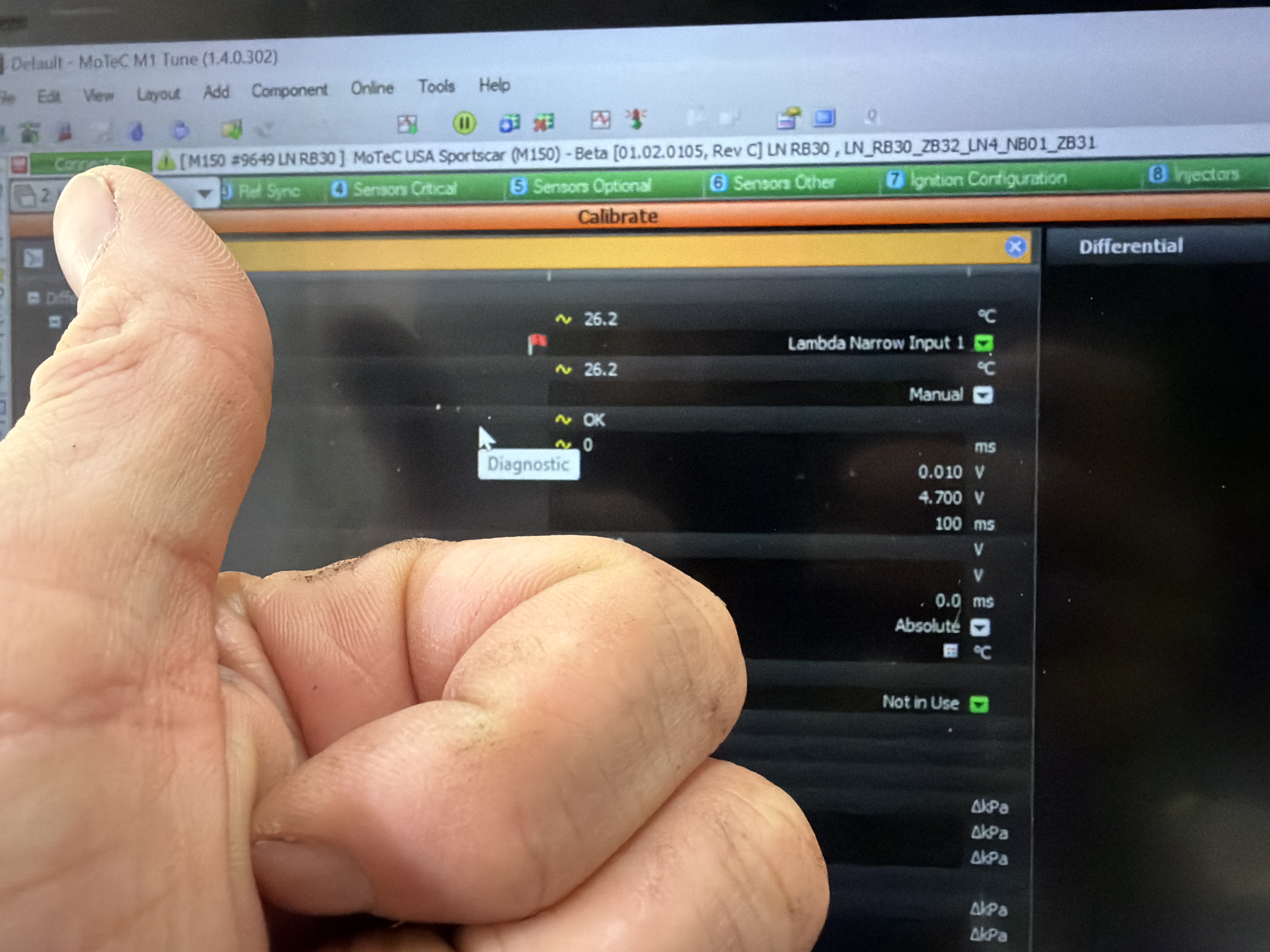

we would have but we are all out of inputs short of a can expander.

All sorted thank you.
