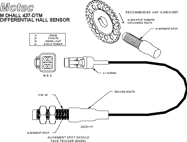

it is MDHall 437, and here is the spec sheet that we have for it.
I know it doesnt answer your questions, so I have asked for a clarificaiton of it for you.
-Jamie

A correction for the thread on this topic as well. The Mhall 437 is a hall effect sensor, not a mag sensor. The difference between the two is the Dhall triggers on ferrous material, the Mhall triggers only from a magnet. We have had great success using the Mhall as a cam sync pickup. (MoTeC USA sensor names used there)
As for an answer to your question, what sensor to use, where are you located? We are looking at a new sensor that may suit your application. It is a hall sensor, has a 0-150deg temperature range, and we have been testing in oil, reading from the front of a camshaft.
email me if you would like more details.
