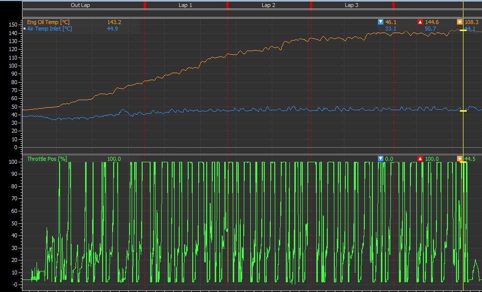

Re: Oil Temp Sensor
Postby Martin on Thu Apr 08, 2010 9:40 pm
This is after 3 flyers...100% pace
This car is turbocharged, see intake air temps.
If its in a race it will go even higher. It settles at about 150`s. If the car follows others closely in the race the temps go higher. Never had wear related issues, oil changes not abnormally frequent. Only bearing failures were RPM related after then engine was over revved on downshifts.
