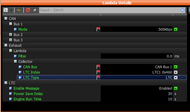

In M1 tune, if you access the worksheet Initial Setup 2, you will have 2 different tabs; one called Lambda Single and another called Lambda Bank.
Can you tell me which of these you have currently configured?
IIRC there is a funny issue where there will be a timeout reported if you have used the bank configuration but only configured one bank. I'm not sure whether a more recent version of the GPR package has fixed this.
Below is how i configure the lambda setup for a Single LTC vehicle that i have found eliminates any warnings or errors within M1 tune.
Lambda Single:
Lambda 1.PNG (17.92 KiB) Viewed 23054 times
Lambda Bank:
Lambda 2.PNG (22.19 KiB) Viewed 23054 times

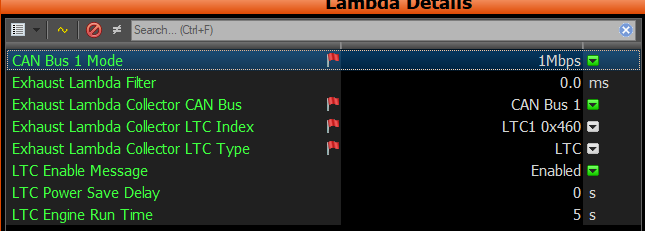

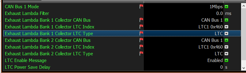

Hello Ryan,
Yes I have the LTC Manager software. That is how I changed the bit rate to 500 k/bits
Here are screen shots of settings you mentioned.
Ray.
Lambda Settings
Lambda Bank Settings
Re: LTC CAN Timeout
PostPosted: Wed Oct 17, 2018 8:35 pm
by rntechnologies
I notice that you mentioned your device was an LTC-NTK, however in your configuration, you have specified LTC rather than LTCN.
Can you change this over to LTCN, as this is used in the initialisation of the LTC device from the ECU.
