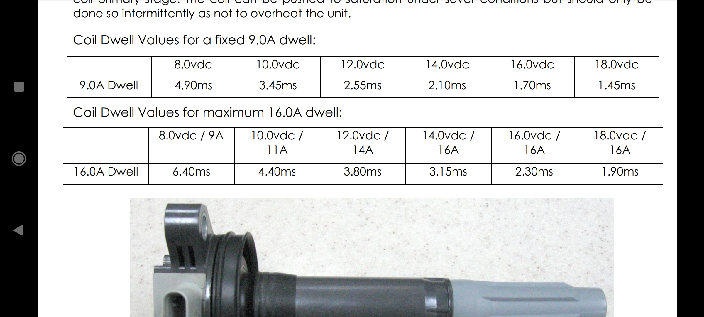

Postby DynoDom on Sat Oct 08, 2022 4:25 am
Again, thanks for the great support.
In the meantime though, a Motec Rep sent me your internal document with dwell Info.
For the benefit of others, I attach the Info here:
