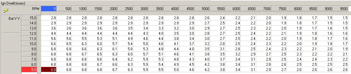

Postby aldearacing on Wed Jun 03, 2009 1:21 am
Need the RX-8 coils dwell table for Motec M600 version 3.5.
Thanks in advance..

Postby Martin on Wed Jun 03, 2009 5:01 am
This is what I use

Postby Martin on Fri Jun 05, 2009 4:03 am
I have used this in a race car without coil problems, RPM limit at 10 000

Postby RossB on Fri Jun 12, 2009 2:38 pm
Looks like Martin has done a bit of work on this but this is from our file for part #N3HI 18100
Volts Dwell
8 9.5
9 7.7
10 5.9
11 4.9
12 4.2
13 3.7
14 3.3
15 2.9
