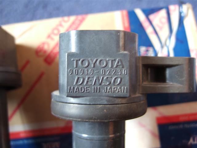

Not strictly Motec but I know this is now a popular coil on plug igniter, does anyone know either the Toyota or other part number for the connector plugs and pins, and where I can buy them please? Thanks, pics below:
and

Hello Chris,
We don't sell them here but you may be able to buy them from Toyota. I believe the idea is to ask for a repair section for the coil which should include a connector terminated with a length of wire.

For the record, should anyone search this, I have just been sent pictures of 1ZZ-GE coils which appear to have the exact same connector style, and the following info. I am ordering some tomorrow, I'll confirm they fit later in the week, hopefully :) Use at your own risk!
Here are the Toyota part numbers for the 1ZZ-FE coil pack connectors:
! x Connector: 90980-11885
Pins (x4): 82998-12440
Toyota connector pins with 160mm wire - Toyota P/N 82998-12340 (USD $4.43 each)
I have not used these, so I do not know how many are required - likely 4 per.
Pinout, looking into the coil connector moulding itself :
Left to right : Ground - Trigger - Tach - 12V

Chris, Toyota only sells the pigtails for these connectors. You can purchase the terminals seperately from Ballenger motorsports. The terminals are a Sumitumo TS terminal 2.3 type 90. The seals can also be purchased from them. This ways you don't need to splice wiring between the pigtails and the harness.
Most of the Toyota stuff uses these terminals. The newer stuff has changed to something else. I'm still doing research on it.

In racing applications, various Toyota engines have had isues with the terminals loosing tension due to either heat or vibration (or both).
I would recommend potting fly leads into the coils and running fly leads to a sealed connector.
The Toyota engines in the Japanese SuperGT series run their coils this way for this reason, along with Toyota Racing Series cars both in New Zealand and Japan.
