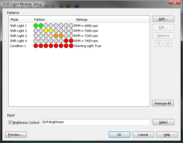

Re: SLM brightness
Postby JamieA on Mon Feb 15, 2010 8:42 am
The SLM Brightness option on the bottom of the SLM setup screen associates the current SLM brightness level to an input, called SLM Brightness.
Once you turn this on, you can assign an AV input to this channel. You can have the AV attached to a dimmer dial, for example, and then you can adjust the brightness with a dimmer dial.
You can also attach it to a digital input with an on/off output. That output can be used in a table to go from one fixed brightness level to another.
There are many ways to do what you are after, depending on how you want it to work.
