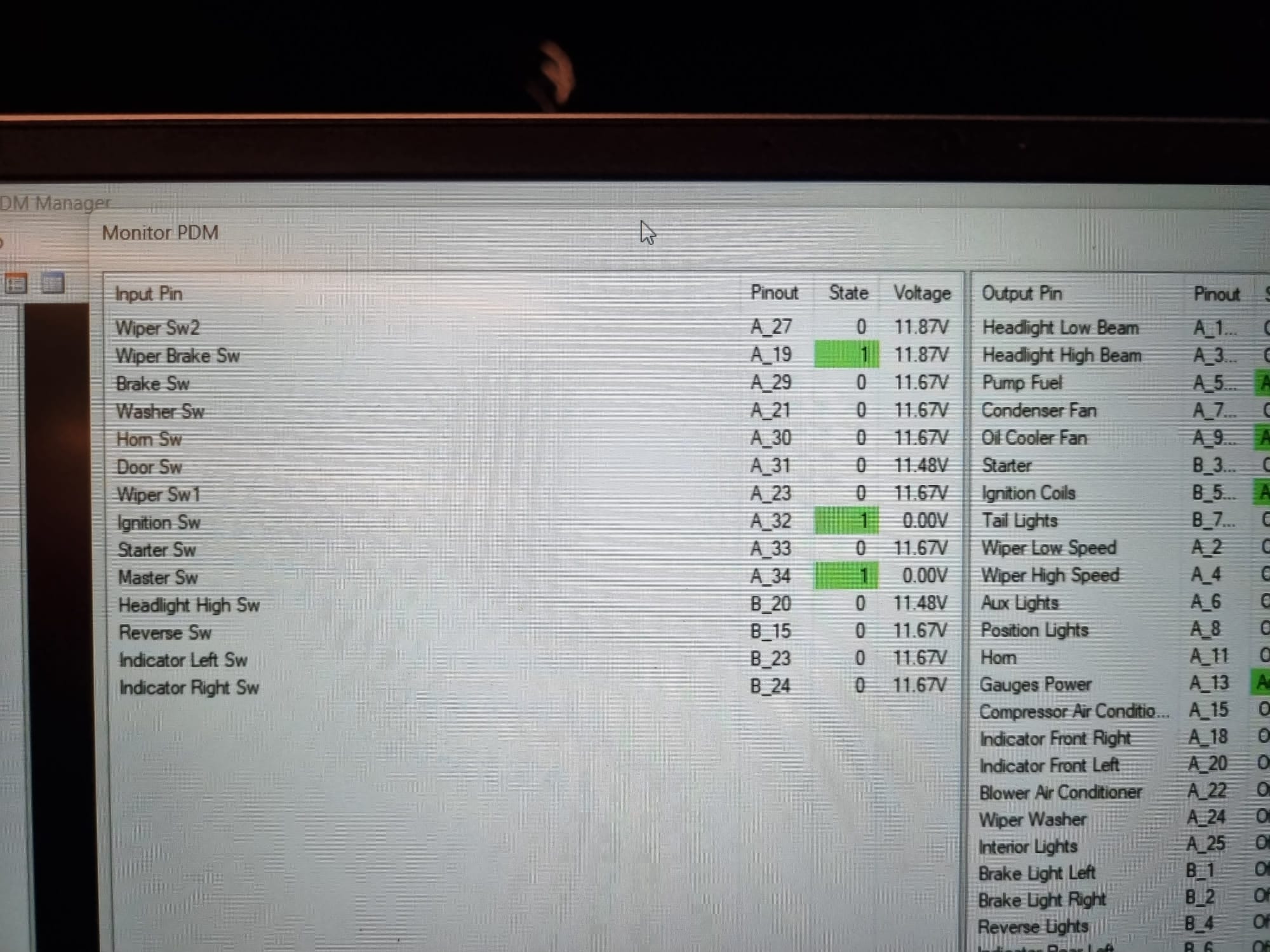

1. The Wiper "Parks" when the Wiper Brake Switch is High - screenshot attached.
With the Wiper Brake Switch setting as High, the wiper properly parks every time from no matter which stage of the wiping it is at when the wipers are turned off so I think this setting is good.
2. When testing the PDM Outputs independantly, The Wper High still exceeds the Amp draw of Output 10.
I will try a different grounding location.
Additionally, the wiring on the PDM Ouput side is exactly as you have suggested however I will recheck if the Wiper Low Switch is actually switched off while the WIper High Switch is switched on.
Wiper Brake Switch High
911 Help.jpg (331.84 KiB) Viewed 96210 times
