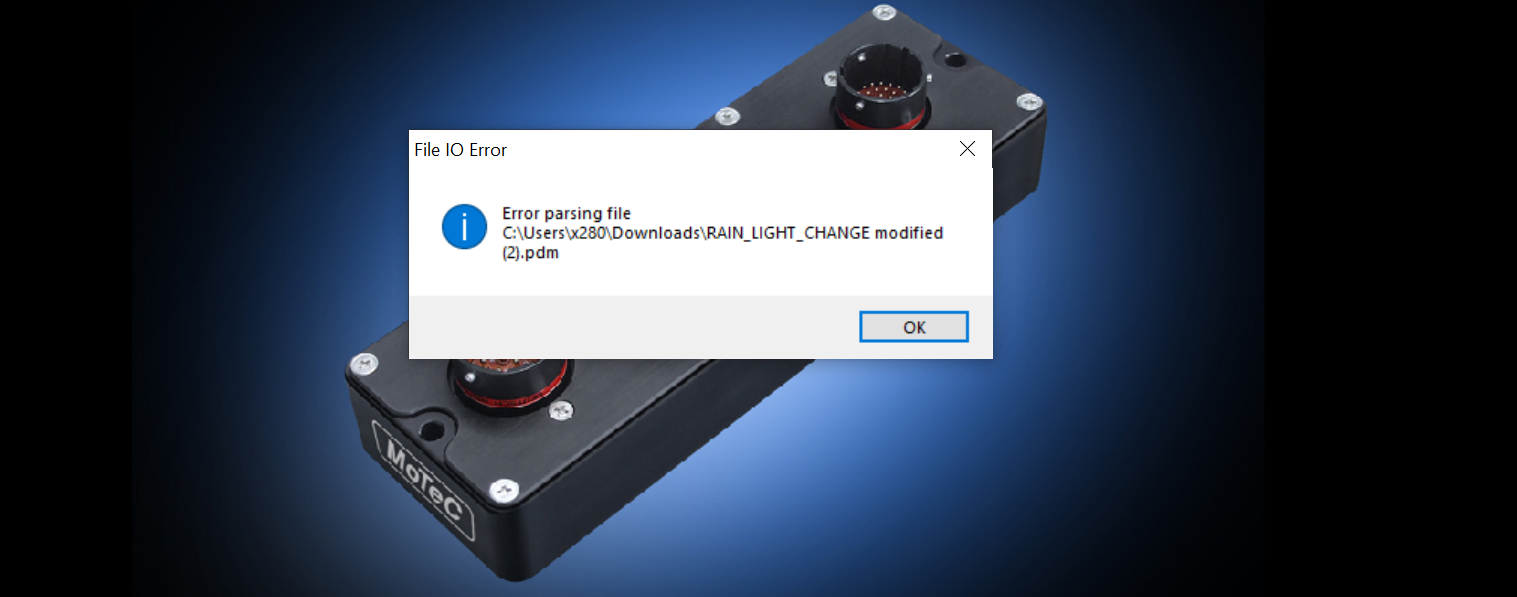

Postby nybimmers1 on Fri Mar 24, 2023 9:32 am
Hi David,
I am getting this error when trying to open the file.
pdm error.PNG (577.59 KiB) Viewed 8254 times
nybimmers1
Posts: 12
Joined: Wed Feb 13, 2019 9:15 am
Re: Rain light flashing
Postby David Ferguson on Fri Mar 24, 2023 9:33 am
What version of PDM manager are you using? I was using v1.9.1.0058. This is the latest version for download.
Posts: 1461
Postby nybimmers1 on Fri Mar 24, 2023 11:03 pm
Thank you . Needed to update the software and all good now .
