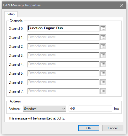

On the PDM.
PDM Transmit.PNG (14.89 KiB) Viewed 11027 times
The CAN Address used must match the CAN receive in the M1.

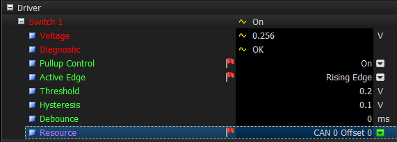

On the M1.
M1 Receive.PNG (14.21 KiB) Viewed 11027 times
This will transmit a message of 256 to the M1, this is read as 0.256V when active, and 0.000V when off. If the Hysteresis and Threshold values are set as shown, then the switch will work.
The Transmitted message must be on the even channel to get the higher number, if it is on a uneven channel, then the message transmitted will be 0.001V
PDM Transmit non working.PNG (14.56 KiB) Viewed 11027 times
