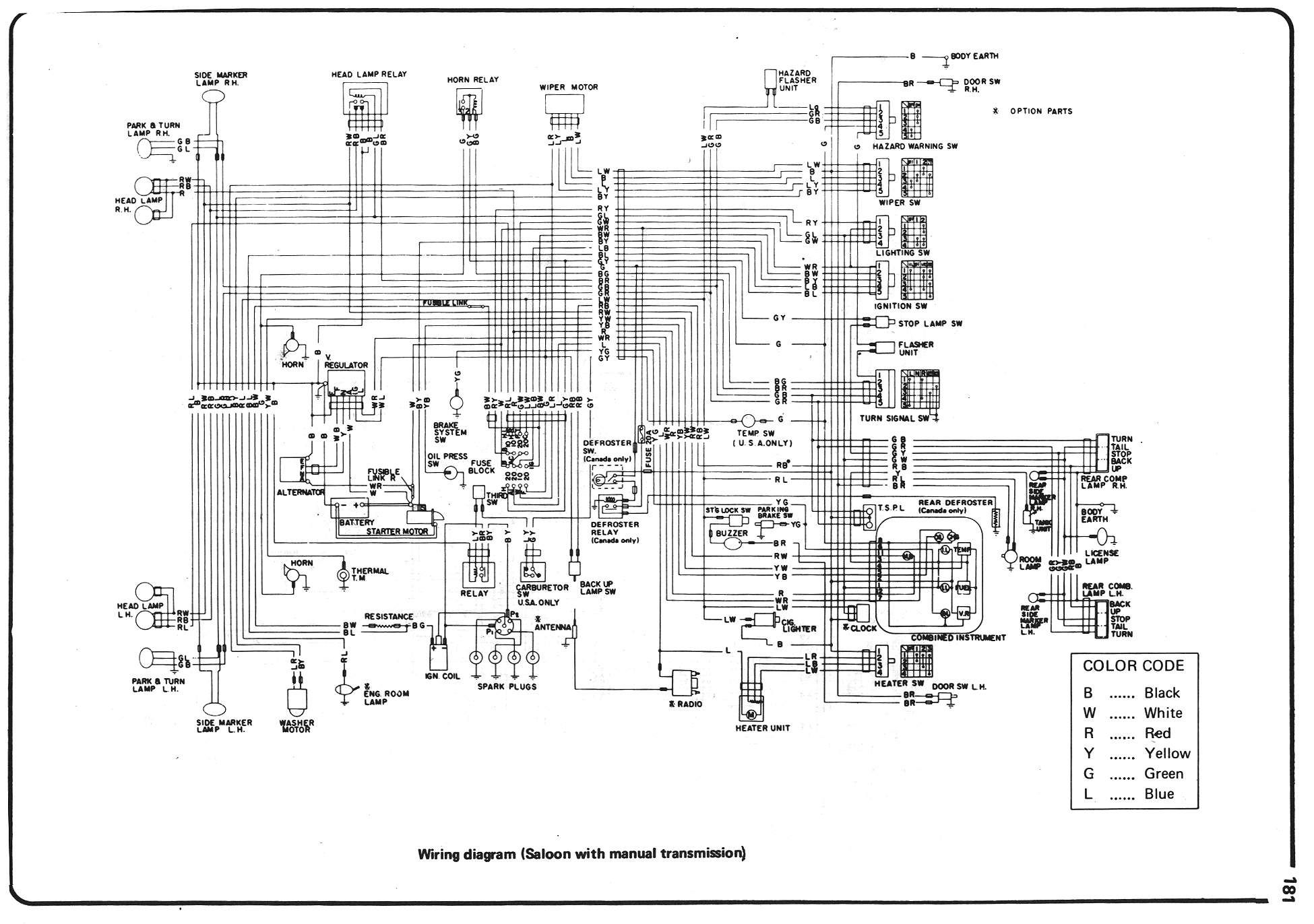

Here’s my project:
viewtopic.php?f=42&t=3450
As I mention in that thread, I’m going to be doing a bit of a sleeper install while attempting to utilize the OEM switches. Some of these will remain integrated with the dash harness, while others will be removed from the harness and converted to simple switches.
The ignition switch used to receive full power to Pin 1 and distribute through the other pins. I will now instead be mapping Pin 1 to 0V and wire discrete Motec Inputs to the other pins.
Some OEM circuits are completed by going to ground, such as my high beam headlights and horn. Some switches send a full 12 volts.
The design objective is to have all OEM switches operational in their traditional way, but also program the keypad to do some of the same work (i.e. start car, flash high beams, etc, )
