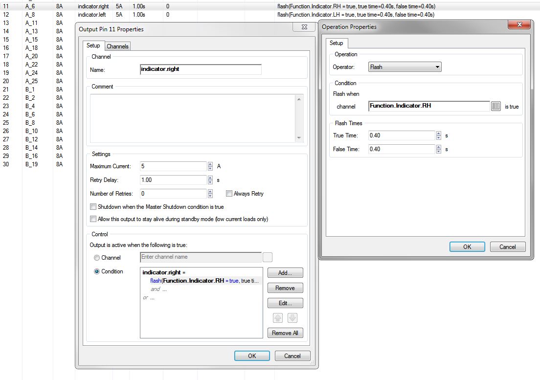

Postby Stephen Dean on Tue Nov 10, 2015 1:21 pm
We have hopefully resolved the issues with file uploads to the forums.
PDM Flash.JPG (116.42 KiB) Viewed 22014 times
Let me know if this doesn't work.
flash test.pdm
(47.36 KiB) Downloaded 1328 times
