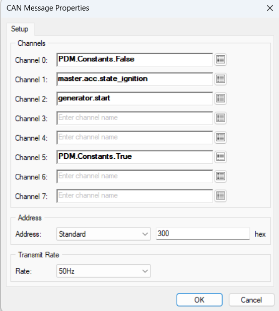

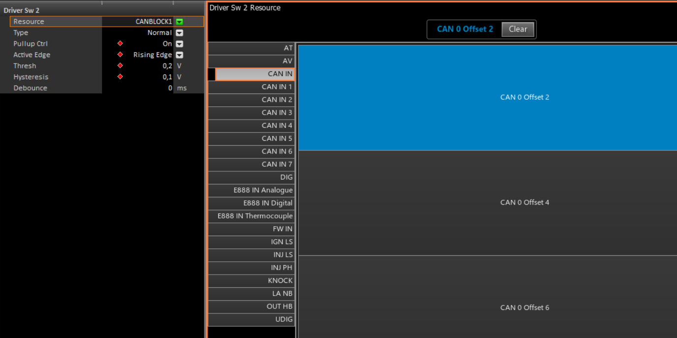

I'm still working on the same engine and now wanted to use a second driver switch controlled by the PDM.
What I want to achieve is to control a driver switch in the M1 from the PDM so that that driver switch can drive an auxiliary output in the M1 when activated from the PDM.
I have configured the "generator.start" in the PDM manager as per attached image.
In M1 tune I then do the following as per second image.
Somehow I cannot get this to run and I'm hoping someone here can help.
My end goal with this is to use a H-bridge in the M150 to activate the generator of the car via the PDM after the car has started. If there is a better way of doing this I would be happy to hear so!
