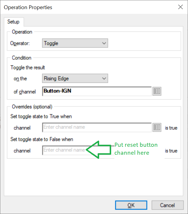

The Master Shutdown isn't a reset, it simply turns off the outputs that are configured to use it when your Master Shutdown condition is true. When it becomes false the outputs will turn back on if the conditions that drive them are still true.
If you want a reset button you should use it to reset your functions. So for example your "Function-IGN" function has a toggle based on an ignition button. Add your keypad reset button to the reset of this toggle (see below).

Postby slmawi on Mon Aug 09, 2021 10:13 pm
thanks for advice its work
