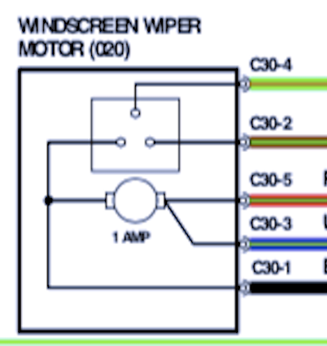

I note that in PMD30 user manual it states that hardware you can directly drive the wiper motor form the PDM with outputs 9. Therefore I have used Output 9 & 10 for the fast and slow windings.
Wiper Motor Pinout
Screen Shot 2019-03-22 at 13.48.55.png (107.56 KiB) Viewed 11183 times

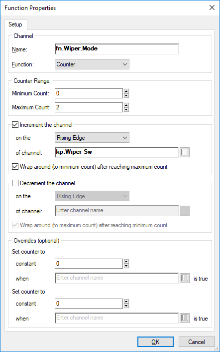

Create a new function, and change it from condition to counter in the drop down box. Use the keypad button as the increment channel and set the maximum count to 2 (see below example).
Then in your outputs make output 9 active when 'fn.Wiper.Mode' == 1 and output 10 active when 'fn.Wiper.Mode' == 2.
Just remember to make sure in the setup for output 9 you select the output for the high speed winding.
Wiper Mode.png (16.36 KiB) Viewed 11136 times
