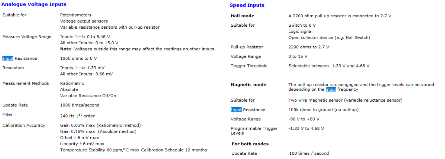

input character.png (202.98 KiB) Viewed 3117 times
It depends on your intended use case. It is advised not to use them for high speed or precision sampling.
