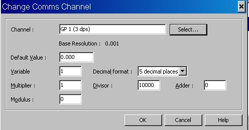

*change the settings to match the following picture (you can edit the channel name to time if you wish)
comms channel settings
This now gives you a channel with only hours, minutes and tens of seconds.

Re: ADL2 time display
PostPosted: Wed Jan 28, 2009 2:50 pm
by JamieA
If you are using the Garmin GPS18 or 18X instead of the blackline, you should use these settings instead.
