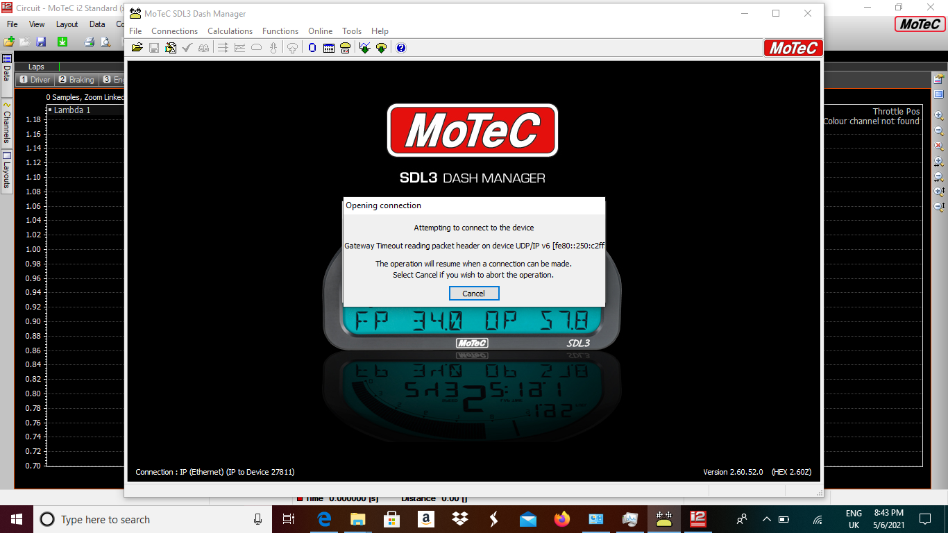

Postby Blue1878 on Fri May 07, 2021 12:33 pm
I guess something is wrong as keeps saying cant connect - turned my firewalls off etc.. any ideas guys?

Postby Stephen Dean on Fri May 07, 2021 6:26 pm
Have you just installed the SDL3 software, or has it been on your computer for a while? If it is not a fresh installation, can you re run the installer and select Repair as an option. There have been a couple of Windows Updates of late that have had a negative effect on the communications protocols that we use, and by doing the repair process it restores these functions to correct operation.
