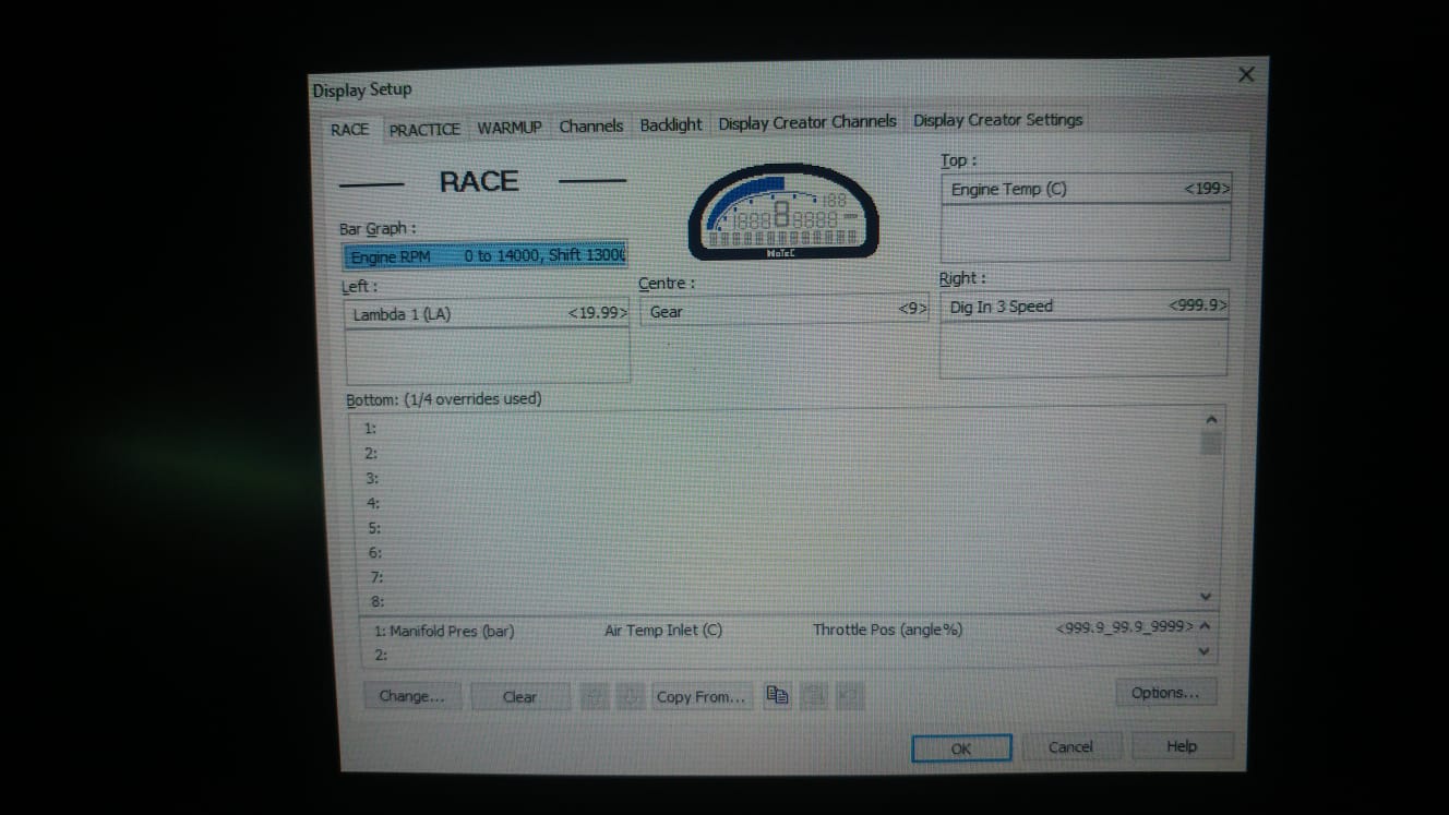

I have a motec cdl3 installed in my gsxr1000 and I can't put the odometer on the display and also the speed in kmh since it only marks the speed in mph, where do I have to go to configure it?

Use the MoTeC CDL3 Dash Manager. You can choose the channels to be displayed, and the units to be used using Functions->Display, just use the Tabs to pick the display page, then select the channel (or screen location) and use the "Change..." button to edit.

Yesterday I did tests to be able to put the odometer and the km, I got speed to go out but the speed marked me in mph and I don't see the option of kph, and the odometer I tried to put it in all the sections and there is no way, the step captures screen to see what I do wrong.

Can you post your CDL3 Configuration? Where is Dig In 3 Speed coming from? Direct connection or ECU data stream?
The issue is that the channel "Dig In 3 Speed" is a unitless channel. I would suggest using a channel designed for ground-speed measurement, such as "Wheel Speed Front" or "Wheel Speed Rear". Basically, you need to change the channel in either your Comms template, or in the channel assignment for your direct input connection.
If this data comes of CAN or RS-232 This can be received in .1 km/h units, and you will be able to choose MPH as the units for display.
Your local dealer that sold you the CDL3 should be able to help with this.
