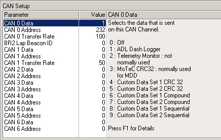

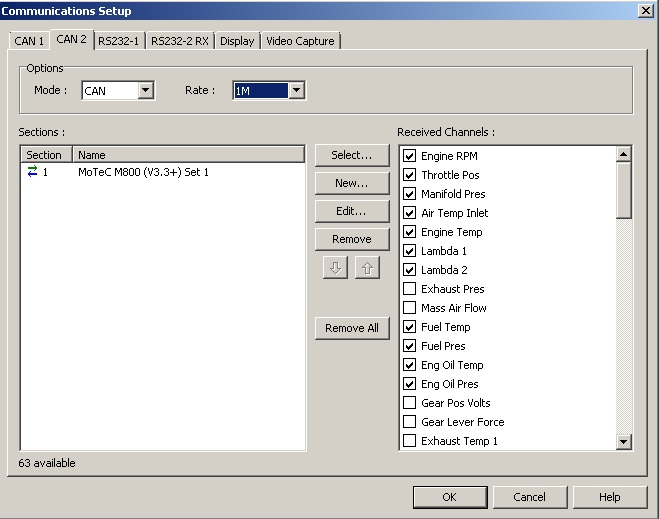

In the ECU CAN2 is a CAN template rather than a separate CAN bus, M800 has one CAN bus only. To transmit data to the dash it should be sent on CAN 0. Assuming you have the ECU wired to CAN2 on the dash since it worked with the M84.......
Try this in ECU manager
And this in C125 manager

Postby fordpop on Sun Jul 12, 2015 5:28 pm
thanks Sean - got it sussed:)
I used the 1520 address on CAN0 in the ecu manager & the template in the dash & we have comms.
