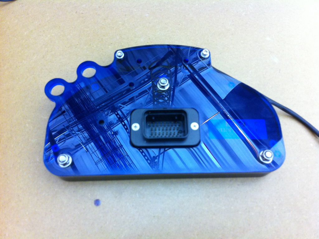

I have these dimensions already in the CAD model, but the profile on the top seems to be three radii blended together. There is the top ellipse and either one or two radii on the side. A laser cut template against the CDL outline suggests there is more than one radius on the side.
The old pics do not show the edge mismatch, but one exists.
