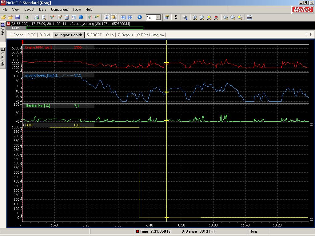

Postby pnanassy on Sat Jun 25, 2011 7:14 pm
my SDL3 odometer resets after 999km,altough its set to display 2 values
Odometer 9999 and trip distance 999.9
Anyway,it resets after reaching 999km to 000km.
How can i solve this?
Thanks,Peter

Postby JamieA on Thu Jun 30, 2011 5:39 pm
can you send to me some logging showing this?
this will help me diagnose the issue.
thanks.

Postby pnanassy on Tue Jul 12, 2011 5:56 pm
log,and config sent to your email address.
This picture shows the strange thing happening:
