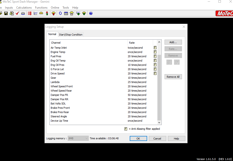

Hi Everyone,
I am looking at purchasing a second hand Sport Dash with 8mb logging enabled. I wanted to check to see how long the logging time would be before I purchased it. I set up a config with the likely sensors I will used.
This may be a silly question but I'm guessing this is 3 minutes? IF this is the case is there any way of expanding the memory?
James
logging time
Screenshot 2021-02-18 123652.png (41.12 KiB) Viewed 7138 times

Postby SprinterTRD on Thu Feb 18, 2021 4:56 pm
That's 3 Hours of logging!
