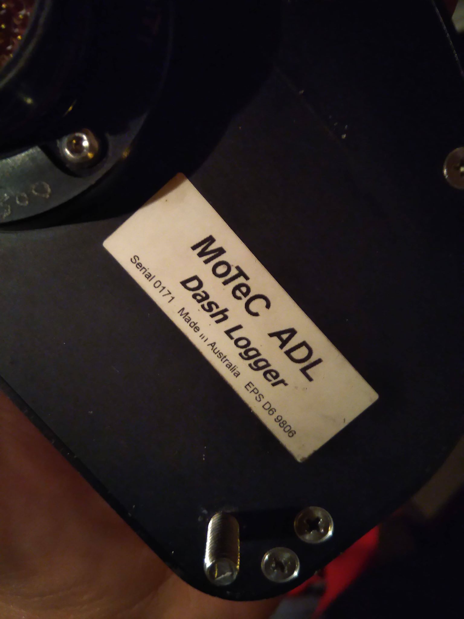

Hy Adrian, here are some pictures. Note, that on the connector, there is a wire attached to pin number 6

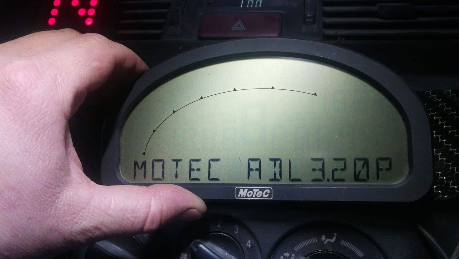

The version of Dash Manager i'm using is 3.2.0.152 with the 3.20U HEX file. Dash manager tells me that the dash needs 3.20P HEX file. And i was not able to find on the website under old releases a dash manager version that matches with 3.20P HEX file. Thanks again.

Postby adrian on Tue Mar 26, 2019 10:06 am
Unfortunately that unit doesn't have the backlight module installed.
How are you connected to the Dash? Via CAN or Serial?
If you are connected via serial it won't let you do a firmware upgrade, you need to connect via CAN to be able to do that.
You can download 3.20P from here if you wish to continue using that version but I would recommend upgrading to the latest version.
