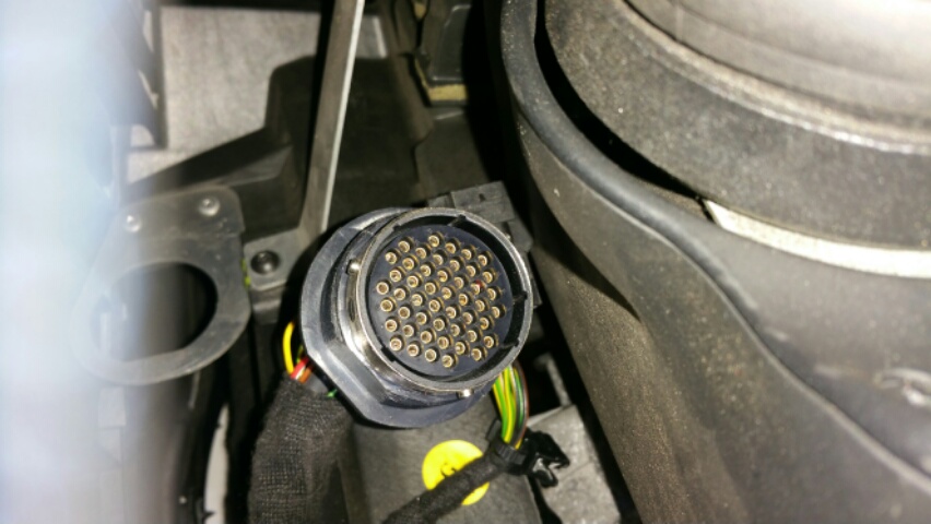

i want install brake pressure sensors to the adl2 - i have 3 connectors in the car from them two are for the pressure sensors and one for the steering angel sensor.
i have checked the two connectors where the signal arrives on the big connector of the dash (48 pins - see attached pic)?
you speak always from a 79pin connector but i have only the 48pin connector?
the signals from the two equal connectors go to pin 18 (yellow) and to pin 19 (yellow/blue) and one connector goes to pin 27 (orange/white) and to pin 26 (orange) - so it seems the pin 26 and 27 are the sensor signals and 18 and 19 are positive or negative.
i have enclosed a pic where the pins are described but can not see how this work with my pin 18, 19, 26 und 27.
can someone explain which pin i have to enter the values of the sensors?

here are some additional pics.

The 79pin connector is on the back of the dash, it should look like this:
The Motec pin numbers refer to this connector so you will have to trace your wires back to the main dash connector. The connector you have shown is from a 3rd party and not part of the standard Motec loom so I doubt anyone here will have a pinout for it.

On the ADL2 equipped 997 GT3 Cup cars that I have worked with, the brake pressure sensors are connected to AV 2 (front) and AV 3 (rear). The steering sensor is connected to AV 1.

thank you david,
i installed the sensors and the very important info from you that the av2 und av3 are connectet to the pre installed plugs helped me a lot.
