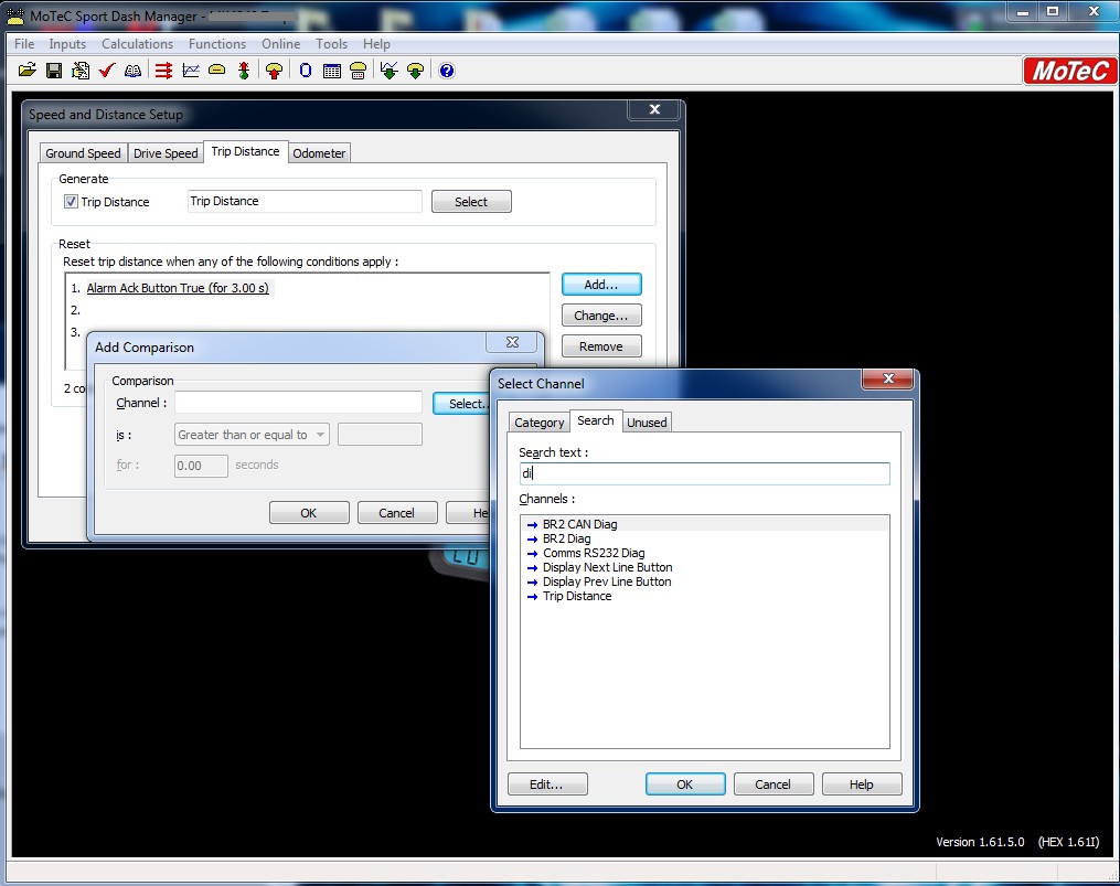

Thanks Adrian, but I can't find the display mode conditions.
Here's a screen shot of what I get when searching 'di' to bring up all options for the word 'display'.
SDL reset button.jpg (116.75 KiB) Viewed 19203 times
Am I looking in the wrong place, or is this only available on the ADL and not the SDL?

Go to the display setup (Functions>Display) and click on the channels tab. Make sure the 'Display Mode' channel box is ticked.

Ticking that box did the trick, and ADL display mode now appears. Car isn't mobile at the moment so I can fully test, but I'm sure it will work :)
