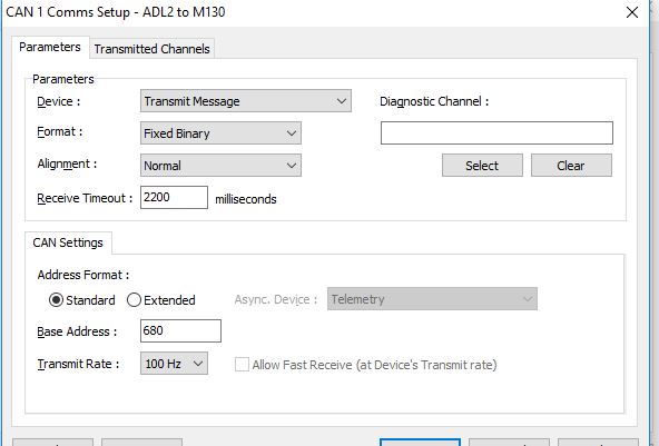

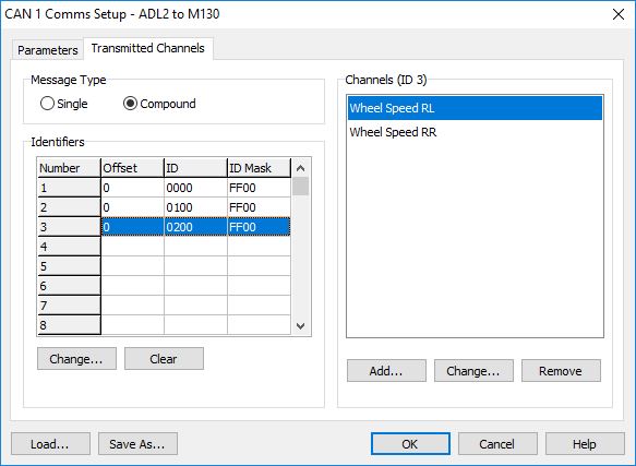

Hello all,
I have watch the Motec CAN youtube video but somehow I'm still missing something. I'm trying to send a few information from the ADL2 to M130 and keeps running into issue.
Information to be sent from ADL2 to M130
-GPS information
-Switches (Boost Trim and Calibration Trim)
-Wheel speed sensors

Postby David Ferguson on Wed May 09, 2018 3:10 am
The GP Packages don't decode compound messages. You need to be transmitting individual messages with the appropriate address. Now 0x680 is aready in use with the GPS_to_M1 templates (posted on this forum, but I included them below), so for your wheelspeeds, and boost settings, you need to use something different. I chose 0x500 in the files attached to the next posting

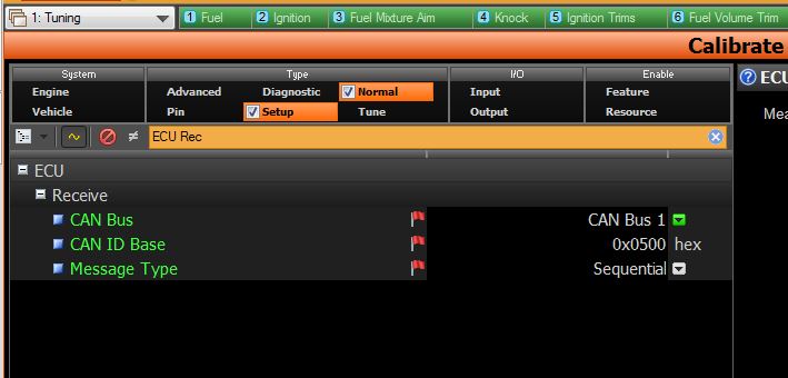

Now to configure the M1 to receive the data at CAN ID 0x500, you configure the ECU Receive as follows:
M1 Tune CAN Setup.JPG (43.69 KiB) Viewed 18583 times
To configure the Wheel Speed Front Left you would use CAN 0 Offset 0 as follows:
M1 Wheelspeed CAN Setup.JPG (35.96 KiB) Viewed 18583 times
Similarly for the others:
Front Right CAN 0 Offset 2
Rear Left CAN 0 Offset 4
Rear Right CAN 0 Offset 6
Boost Trim will be at CAN 1 Offset 0
Calibration Switch CAN 1 Offset 2
Hope that helps.
