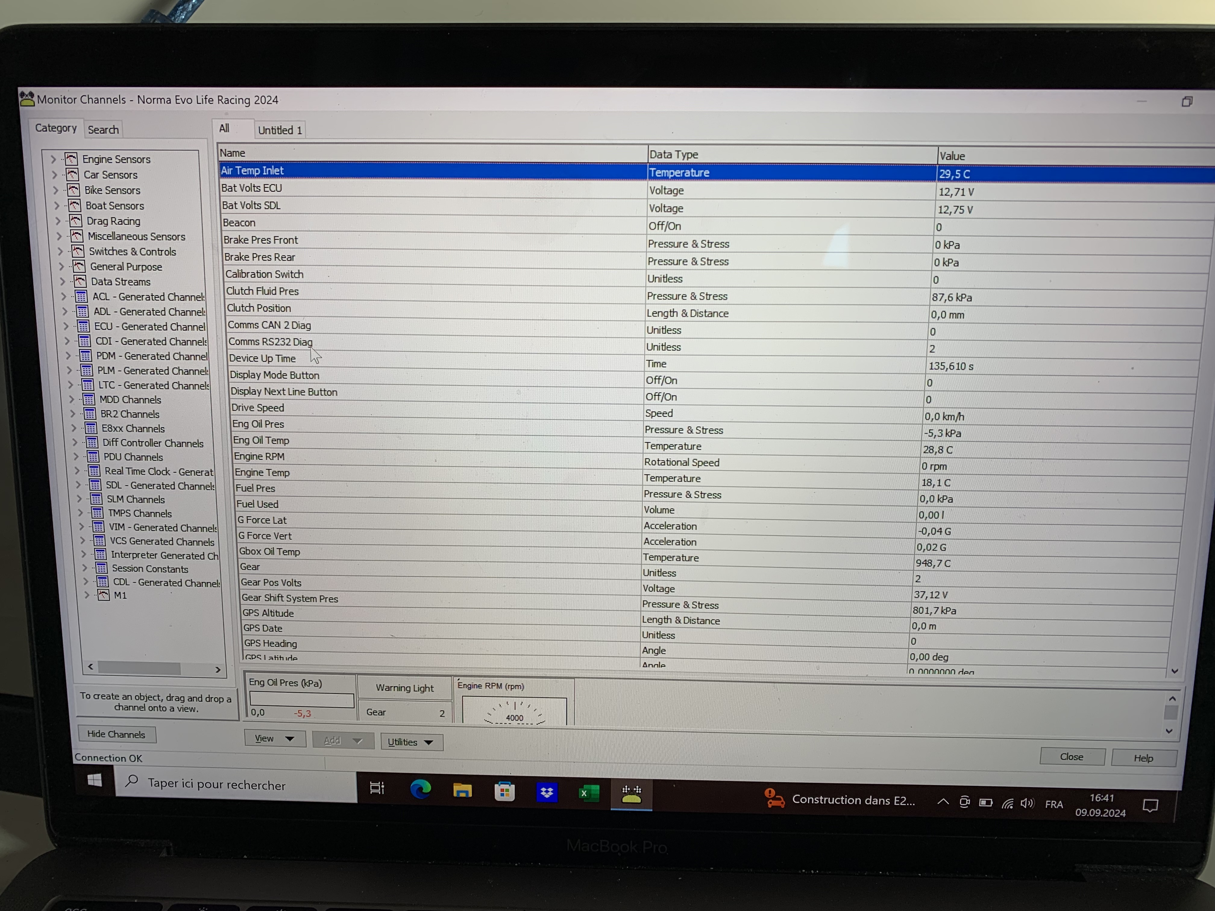

There is a channel called Comms RS232 Diag that reports the status of the RS232 port, can you have a look at this channel in Online | Monitor Channels and report what is being shown.

This is what I have on my screen

Assist if you want to look in to it this afternoon, before Stephen gets to read this tomorrow morning.
2 FRAMING
Not seeing the stop bit. The baud rate or stop bit setup is wrong or there is electrical interference causing errors in the data.
