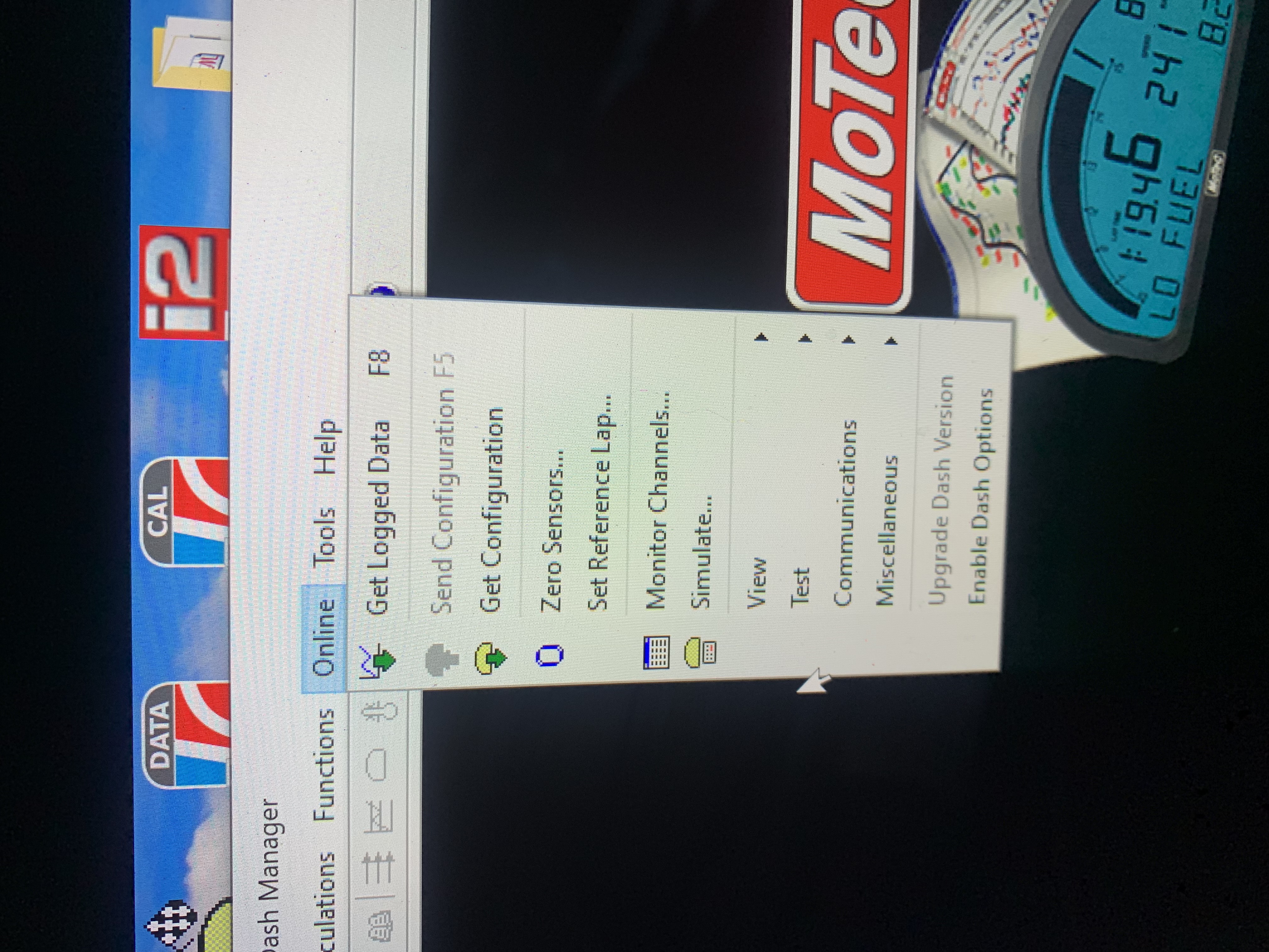

I have a dashboard SDL sport.
it was working on version 1.61.B and I downgraded it to version 1.52.D.
Now I can't update it to version 1.61.I, dashmanager doesn't offer it to me.
dash manager 1.61.I does not offer me updates. And Dashmanger 1.52.D says firmware is updated.
How can I do it?
Thank you. Jimmy

Hi Jimmy,
These options are greyed out because Sport Dash Manager is configured to communicate on the secondary CAN ID.
This is under Tools>Connection Settings. If USB or Prmary CAN isn't listed as an option then click the 'Add' button to make this option available.
Highlight the USB or Primary CAN option and click the 'Make Active' button, the upgrade firmware option should no longer be greyed out.
Are you using USB to communicate with your SDL?
The secondary CAN communcation option exists as the primary IDs may already be used by another device which may be why yours is configured this way.

Thank you ! It’s ok
