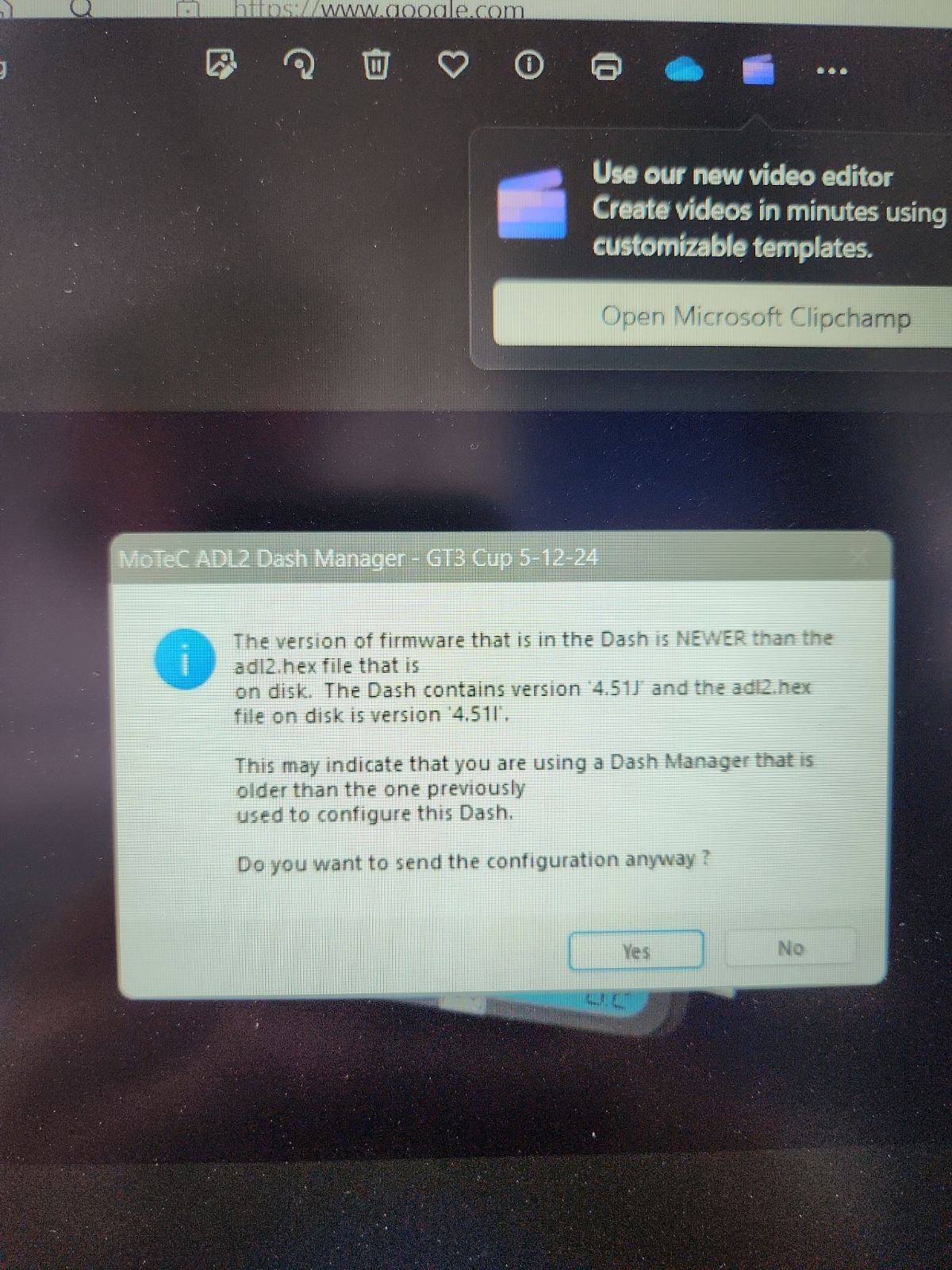

Helping working on 997.1 cup car with an ADL2. The newest ADL2 dash manager on the Motec website is 4.51.0.I4 and dash has 4.51J (see attached screenshot). is there another place to download J ? If not I'd like to update things to the I version on the software downloads. How would go about changing the manager/dash firmware to I ?

I would use Online->Upgrade Dash Version, and let the 4.51I4 Dash Manager put it back to 2.51I.
