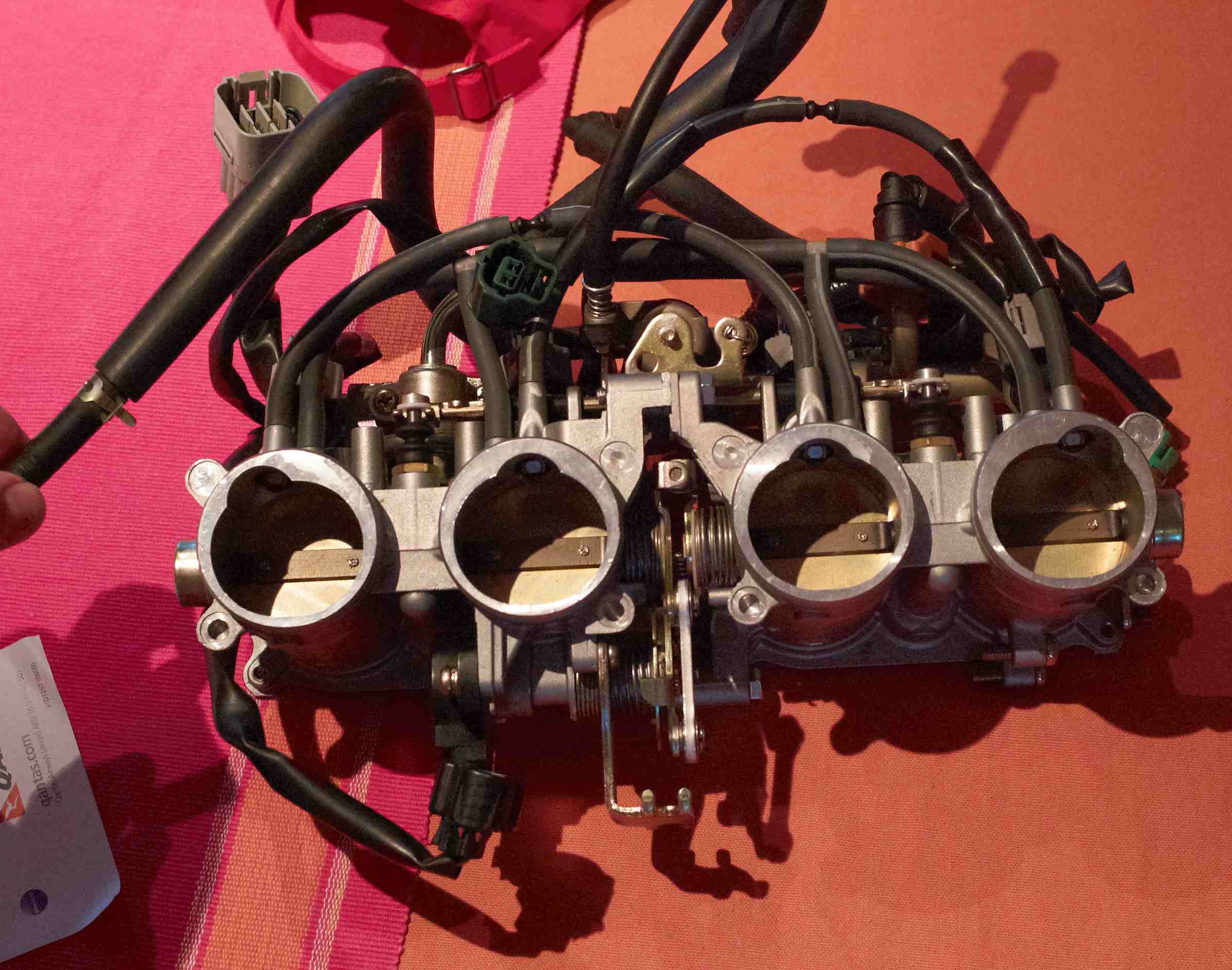

Well I am not too sure which year.
I got them off a guy who tried these and a few others and he ended up using Kawasaki TBs.
I am hoping pictures will help...
The actuator is directly in the centre of this photo under the snake festival of hoses.
centre of photo
Holmz
Posts: 521
Re: M800 on 08 Yamaha R6
Postby IDP on Wed Apr 07, 2010 8:13 am
These are 2004/5/6 Throttles.
The actuator you are looking at has engine coolant flowing through it and simply opens up air bypasses in each throttle.
This just raises the idle when cold.
The only idle adjustment is with the knob on the end of the flexi drive that lifts the stop on the end of the actuator link.
The only idle control the ECU has is with Ignition advance.

Postby Holmz on Wed Apr 07, 2010 9:44 am
IDP wrote:These are 2004/5/6 Throttles.
