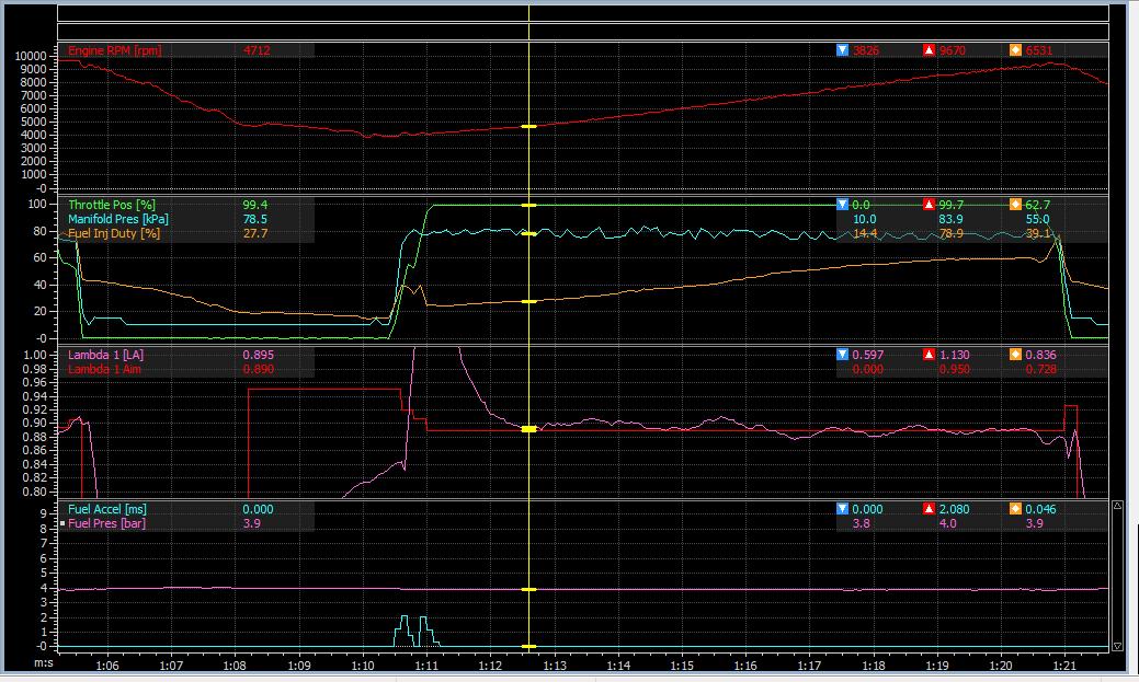

Do rotaries require more accel enrichment than piston engines?
Ive tried running it with overrun fuel cut and without, also adding extra fuel on overrun to keep the fuel in the inlet on overrun.
This particular engine is a stock RX8, 3 injector per rotor type. (6speed gearbox)
Injectors are staged, 1 at port (primary) 2 higher up (secodary)
logging

I take it from the logging you get a big lean spot when you hit the throttle? Have you tried increasing the accel enrichement sensitivity?

Yes that lean spot is the problem as you get on the trottle.
IJPU = 10ms
Baro reading was 84.7 Kpa during this session
Could it need any more than this??

The short answer to your question is YES, I have not tuned a lot of Rotaries but the ones I have, had some big numbers in the Accel, over 100 in some cases with the IJPU at 12. The only problem with settings like this is you need to make sure your throttle sensor has no noise on it as this will cause false triggers so to speak.

Take a close look at the hysteresis settings for the secondaries, and the amount of enrichment associated with the secondaries coming in.
Your 1600cc secondary injectors are highly non linear in the lower range which is adding to the problem.
And yes, rotaries typically need large amounts of accel enrichment.
