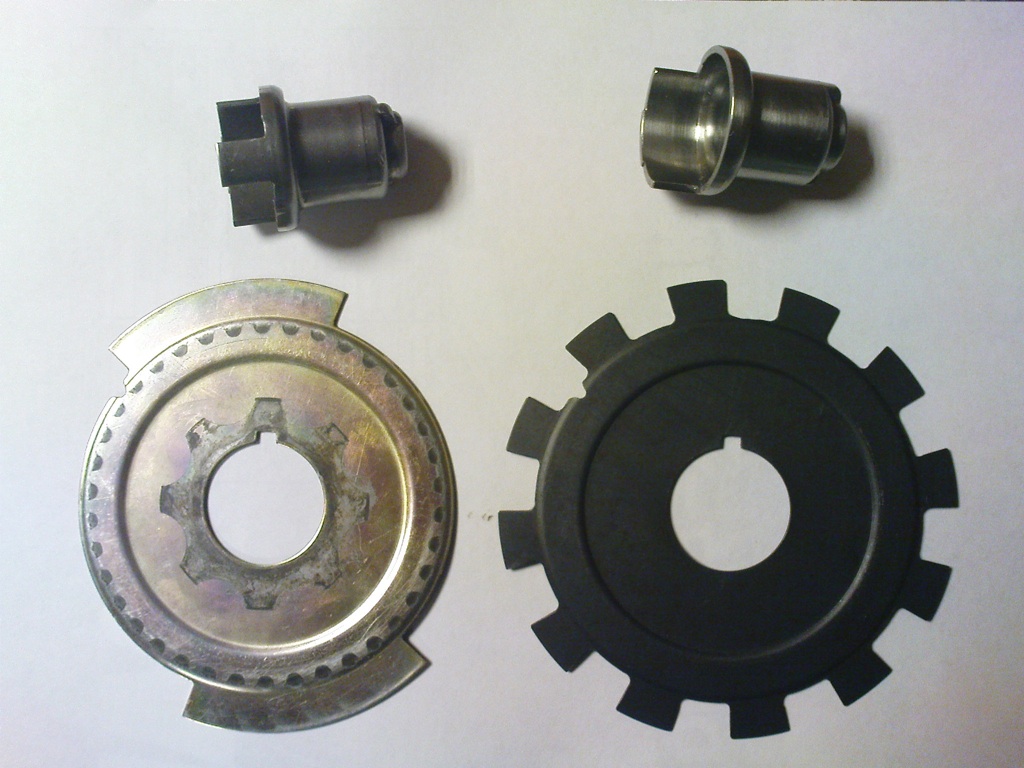

Hi All,
Here is what we made for Mitsubishi 4G63. As you can see the crank wheel is stamped so is fully compatible with the
stock engine. However on Evo 9 we have problem with slow VVT response. Not sure if it is related to the trigger wheel setup we use on this car or some other fault.
Also used made 24/1 laser cut trigger wheels for RB/SR engines.
Regards
Alex
4G63 trigger wheel picture
DSC00080 50%.jpg (206 KiB) Viewed 16078 times
