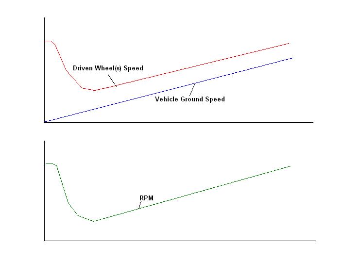

If you put a clutch pedal in you would be able to do something like set off a timer when the clutch is released. The trick with the launch control is that you want to start with too much wheel spin and brin this down quickly to where you need it and then ramp it up as the car accelerates, see diagram. You cannot do this with dual RPM.
You also have problems with 4WD becasue you have no ground speed, you can't use wheel speed sensors by the sounds of it anyway, hence using a timer.
Using the clutch switch you set up a timer (Adjust-General Setup-Timers) and use the timer as an axis on the Launch RPM table. Remember to stop the table axis at the time you want to finish the Launch phase (I assume a second or two), where the table axis stops is where the Launch function stops. You could add a second axis for gear so that the function does not work accidentally around the track.

Postby MarkMc on Mon Jul 13, 2009 10:04 am
Not really as good because you are starting from a set RPM Limit and going up from there you cannot have the RPM drop you need as shown in the diagram.
