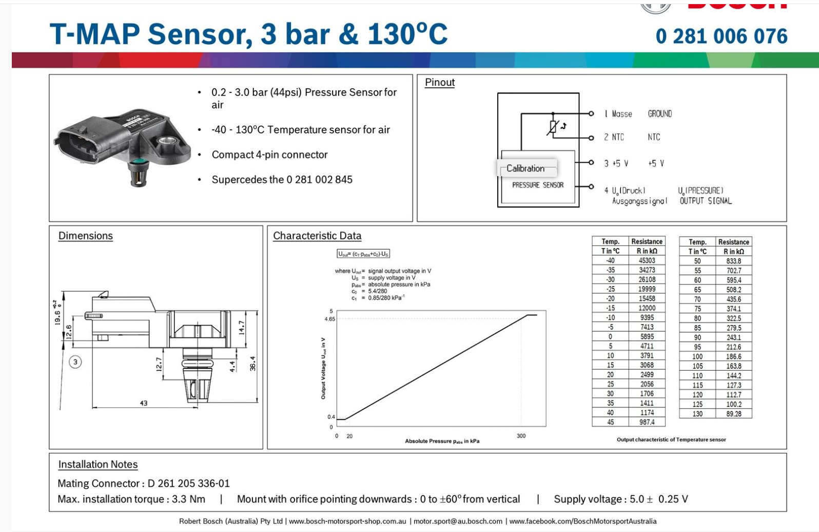

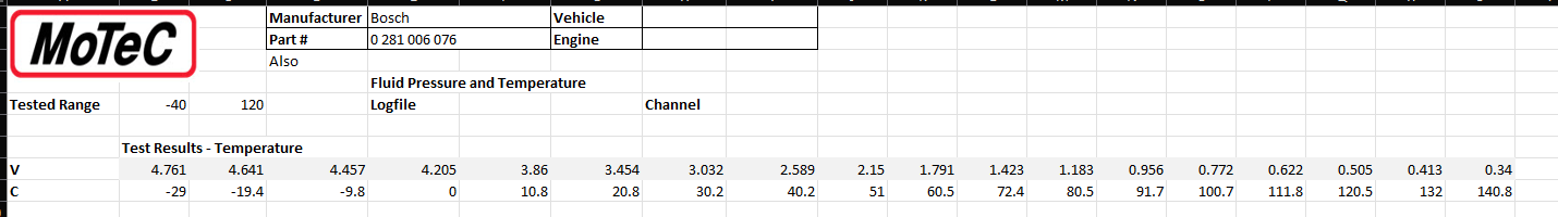

I have a BOSCH 0 281 006 076 in my hand. I want to connect it to the M800. In the calibration table of M800, the read value represents the voltage. How can I convert the read voltage into resistance to obtain the temperature for calibration?

Postby Stephen Dean on Mon Aug 04, 2025 9:58 am
Calibration data for you.

Postby xuge on Wed Aug 06, 2025 3:38 pm
I want to pressure calibration.Thanks.

Postby Stephen Dean on Thu Aug 07, 2025 10:57 am
0.307V = 15kPaA
4.655V = 300kPaA
