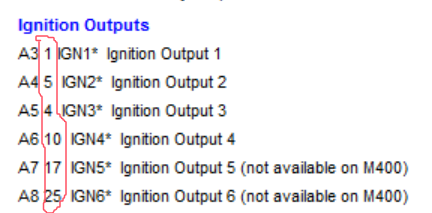

Postby Stephen Dean on Fri Nov 01, 2024 11:23 am
If you are talking about the Help | Pin Number list in the ECU Manager Help, then the number after the alphanumeric number is the matching pin number of the Autosport connector used with the M880.

Postby xuge on Sat Nov 09, 2024 12:32 pm
That's what I circled

Postby Stephen Dean on Mon Nov 11, 2024 8:52 am
Those are the matching pin numbers for the Autosport connector used in the M880.
