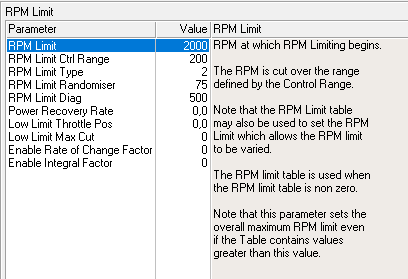

Below, I've included my RPM limit settings as per my knowledge (Adjust -> General Setup -> RPM limit -> Setup). It's puzzling to me that the RPM limit warning appears since, as far as I understand, the settings only account for an upper limit RPM (2000 rpm (heavy duty engine) because of safety). At 1050 rpm f.i., I'm not reaching that upper limit. However, I can't seem to locate how to configure the lower RPM limit as well as the upper RPM limit, since this problem also occurs at f.i. 1250 rpm.

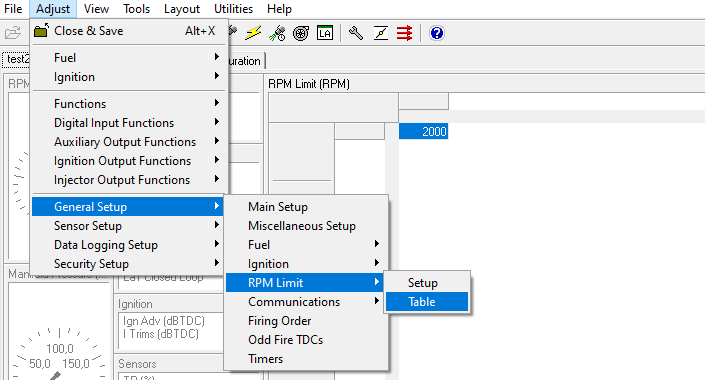

In the picture, you can find the RPM limit setup table.

Postby VolvoPenta on Mon Apr 08, 2024 7:45 pm
Where can I find the config?
In the picture I sent in the previous post, only 1 value is set in the table (do you mean this with 'config'?). In the picture I sent in my first message, you can find the settings concerning RPM limit.

Postby NathanB on Wed Apr 10, 2024 9:01 am
Fail safe.png (24.96 KiB) Viewed 6408 times
As per you config, you have DBW configured, and a failsafe limit of 1000rpm if the drive by wire system is in error.
This is likely the source of the RPM limit you are experiencing.
This is also why Stephen requested a config rather than just screenshots.
Your drive by wire configuration is likely the cause of the issue.
The next step would be to provide us information on the throttle used to see if we have calibration settings for it we can provide.

Postby VolvoPenta on Mon Apr 15, 2024 10:10 pm
Hi all,
The issue has been resolved. Thank you for your assistance.
To conclude the thread: I set the fail-safe RPM to 2000 (which is sufficient for my heavy-duty engine). As a result, I no longer encounter pop-ups.
FYI: When the pop-ups occur, MoTeC enters safety mode and injects less fuel than what is indicated in your fuel map. This caused problems with engine revving. Now, those issues have been eliminated!
