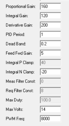

Hello, is it possible to obtain the calibration of this throttle body?
Thank you
BOSCH 0 280 750 085
Re: DBW M800 TB Settings
PostPosted: Tue Jan 30, 2024 8:59 am
by Stephen Dean
Data attached, The greyed out areas are not needed.
Bosch 0 280 750 085.png (18.63 KiB) Viewed 3859 times

Hello, thank you for your attention.
I have the Bosch 0280750081 throttle body with the adjustment provided by you, I have tried the Bosch 0280752251- 4 pin and Hella 6pv00908304- 5 pin gas pedal and I cannot configure the DBW.
I follow all the instructions in DAD0001 Drive by Wire_Electronic Throttle Setup.pdf, but I don't know where I'm going wrong.
Thank you

Hello, well, sir. Thank you very much for your attention. I have managed to solve the problems caused by pedals that are not compatible with the M800.
