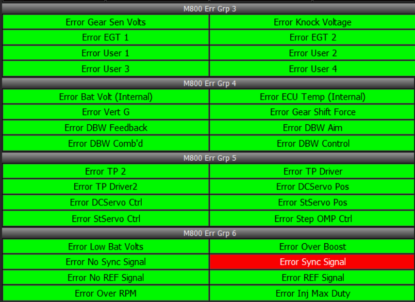

by Stephen Dean
If you have the Error groups logged, in i2 (Standard and Pro) you can add a Channel Bits gauge to your worksheet, this will interpret the bit values of the group into human readable values.
Channel Bits gauge.png (83.82 KiB) Viewed 3090 times
This is done by right clicking on a blank part of the worksheet and going to Add | Gauge | Channel Bits then selecting the appropriate channel.
