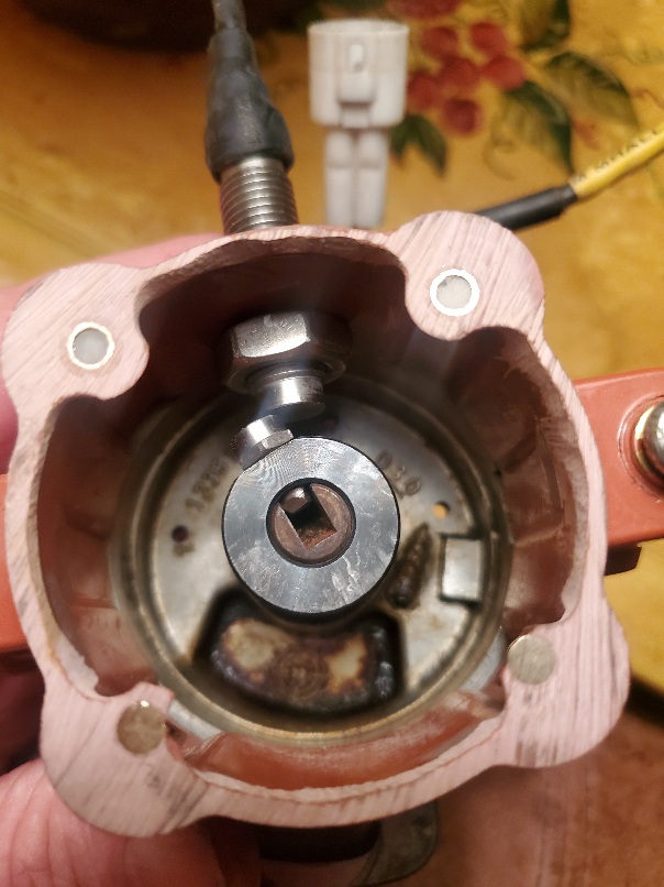

Postby tkarttrev on Tue Nov 21, 2023 5:39 am
Follow up a little off topic, but I would like to pull the cam sync from the existing distributor which has no existing sensors. With the right Hall sensor, coming in from the side, do you believe the sensor will be able to identify the keyway in the picture as the sync trigger assuming I set it up in the software? I will fabricate a cover that would hold the sensor as I will not be using the distributor cap.

Postby Stephen Dean on Tue Nov 21, 2023 9:00 am
Hi Trevor,
What material is that cup made from? It could possibly work, but it is likely that the sensor will also pickup on the depression before the keyway. It may actually be a better option to use the depression as the trigger than the keyway.

Postby Sean on Tue Nov 21, 2023 2:33 pm
Don't waste your time trying to trigger off the notch. Make a trigger wheel with one lug (or notch) that presses on the shaft and is much bigger diameter. In my opinion it won't work well , if at all, trying to trigger off that notch. Eyeballing the size of the notch, seems like the width of the notch will be something like 144 degrees of crankshaft rotation.

Postby tkarttrev on Fri Nov 24, 2023 12:18 pm
I still like placing the cam sync in the distributor, so I mocked this up using a stock cap for simplicity. I used a magnetic sensor, magnet tapped into a set-screw collar. I will machine an aluminum cover with flats to secure the sensor.
What considerations come to mind. Thanks

Postby tkarttrev on Fri Nov 24, 2023 12:46 pm
Is that attachment as giant as it looks?

Postby Sean on Fri Nov 24, 2023 5:27 pm
It's colossal! If you're using a mag sensor the trigger wheel can be plain steel with a single lug. I have never seen a magnet triggering a mag sensor in a ref or sync application with Motec, though it's common enough with MSD.
Make the outside diameter of the trigger lug as large a diameter as you can for more accuracy. Allow for a way to adjust the air gap from sensor to trigger wheel. Can the distributor can be rotated in the normal manner as you would when adjusting timing, so as to be able to move the sync pulse to the optimal position. If not, some adjustment on the sensor mount would be optimal. This is so as to be able to move the sync pulse to a nice position in between the ref pulses. The hundred series ecu don't like the 2 on top of each other I believe you'll find.
